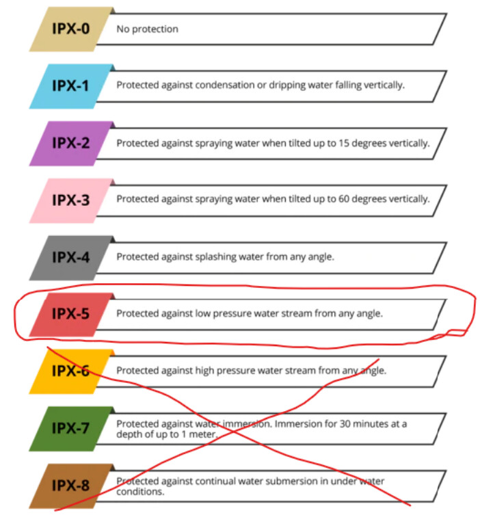

As for the lock bolt, it says it is IPX5 certified, so that means it is certified for everything besides high pressure water streams and submersion:
So the direct rain shouldn’t matter.

Thank you very much! This is extremely helpful. I suspect that in the middle of summer a black keypad that gets 8 hours of direct sun on a metal door on a day that is 95 degrees out will have no trouble easily surpassing 122 degrees. And when I say rain, I don’t mean only rain showers. I mean also tropical storm force rain driven against the keypad on occasion (it gets driven in under the door too when that happens).
