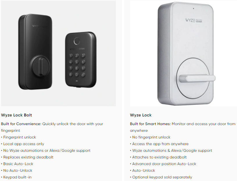

Wyze Lock or Wyze Lock with Keypad
Why would anyone get one over the other? I’m confused why they are selling both of these.
They made a comparison listed on the product page:
There’s also a FAQ page dedicated to the differences (basically the same as above):
Both of them have keypads that can be used with them though, so I wouldn’t call them lock or lock with keypad since both can be described that way. This first one is called the Wyze Lock (recommend using “v1” after it to distinguish this), and the second one is called “Wyze Lock Bolt.”
Hope the above comparisons/FAQ help answer the question.
Okay so why keep selling them both?
They’re different and suit different needs for different customer preferences.
For example, one of the main differences is that some people want their devices to have internet connectivity with remote access (ie: if you forget to lock your door, you can lock it from anywhere; if you’re renting it out to people or running an Airbnb from far away then you can change the codes anytime and any other number of things), you can get notifications, such as that someone left the door open, or when someone unlocks it, or if it’s ajar or any number of things you setup. You can create automations, and control it with Google or Alexa, have things announced when someone unlocks it, or opens it or if it gets left open for a certain amount of time. The possibilities are NUMEROUS. All of those things are only possible with the original Lock V1
In Contrast, some people adamantly absolutely DO NOT want their locks to have any kind of internet access. They are afraid it makes it less secure and many other reasons. This is the point of the Lock Bolt.
Just those 2 alone are enough reason to keep selling both of them. But there are many more.
Some people want an option for a Key to be able to open their deadbolt as a failsafe (Lock V1 only)
Some people DO NOT want a key at all because then it is too easy for someone to break in with basic lockpicking tools in a matter of seconds, or other concerns as well.
We could go through all the differences, but in the end they are pretty different options for different preferences, and a good reason to keep selling both of them.
I have both of them myself, and like them both for different purposes. I have recommended each of them to different family members of mine who have different preferences.
I hope Wyze continues to sell them both for now since they suit different needs.
In the future I’d like them to create a version of the lock bolt that has open/closed sensors like the Lock V1, and has the option to buy an internet gateway for it. That way people could choose whether to have it local only or gain the online benefits, and we can have all the other sensors that make the V1 Lock amazing too. But even then we’d still have the problem of those who desperately want a key and those who absolutely don’t want a key. We’ll have to see what the future holds.
