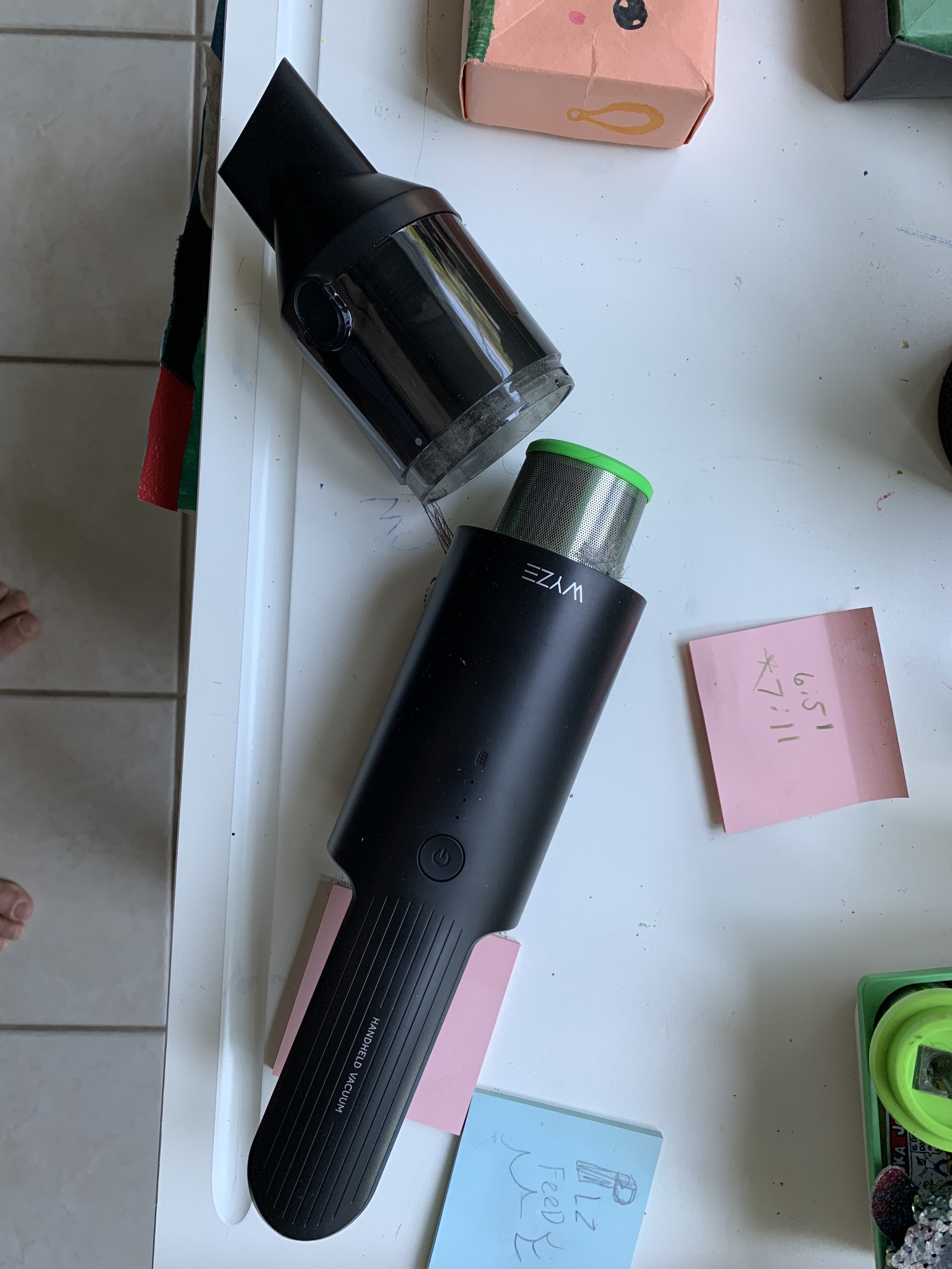

I changed out the HEPA filter with the spare one that they included and it’s fine. I guess I need to wash out the other one.
I have the same problem, everything is clean and the battery is fully charged! First of many Wyze products that Disappointed me.:unamused:
You can actually empty the trash 2 ways. The first way is with the button and I agree you don’t get it all out. The other method is to twist and unscrew the whole container off. This is also how you replace the HEPA filter. I find the 2nd method a more thorough way of emptying the canister of junk.
