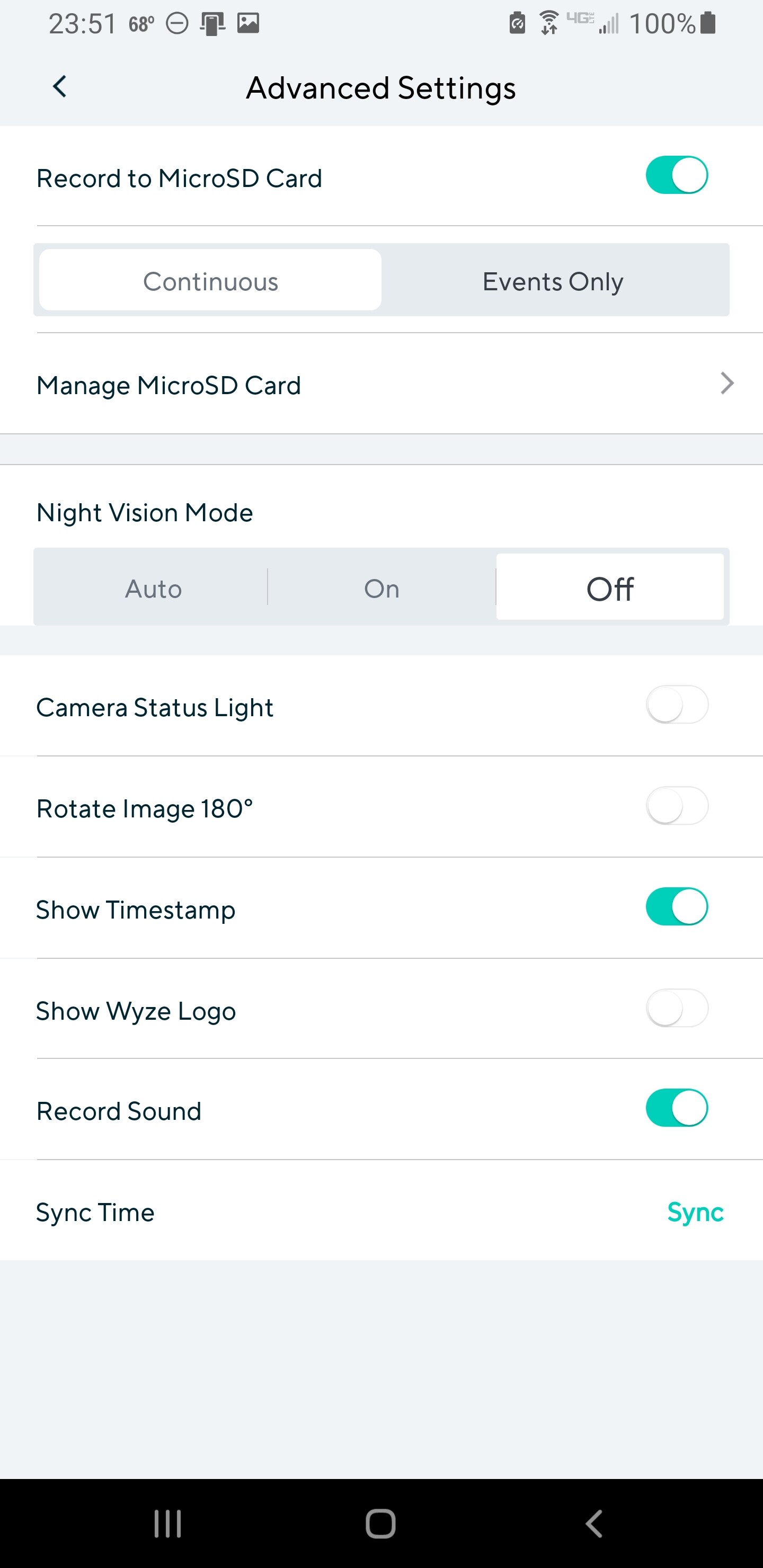

Help I’m no longer getting color night vision with this update. Log submitted 193199 with pictures of v3s with without this update also spotlight only on that v3 is no longer working. Should I just hard reset till a fix?
Color night vision is working on all of my v3 cams with this firmware. Do you have Night Vision Mode off in either Advanced Settings or on the Live view icon? If yes, try powercycling the cam.

You rock Seapup! Had already done a in app restart and that hadn’t fixed anything but 45secs w/o power did.
