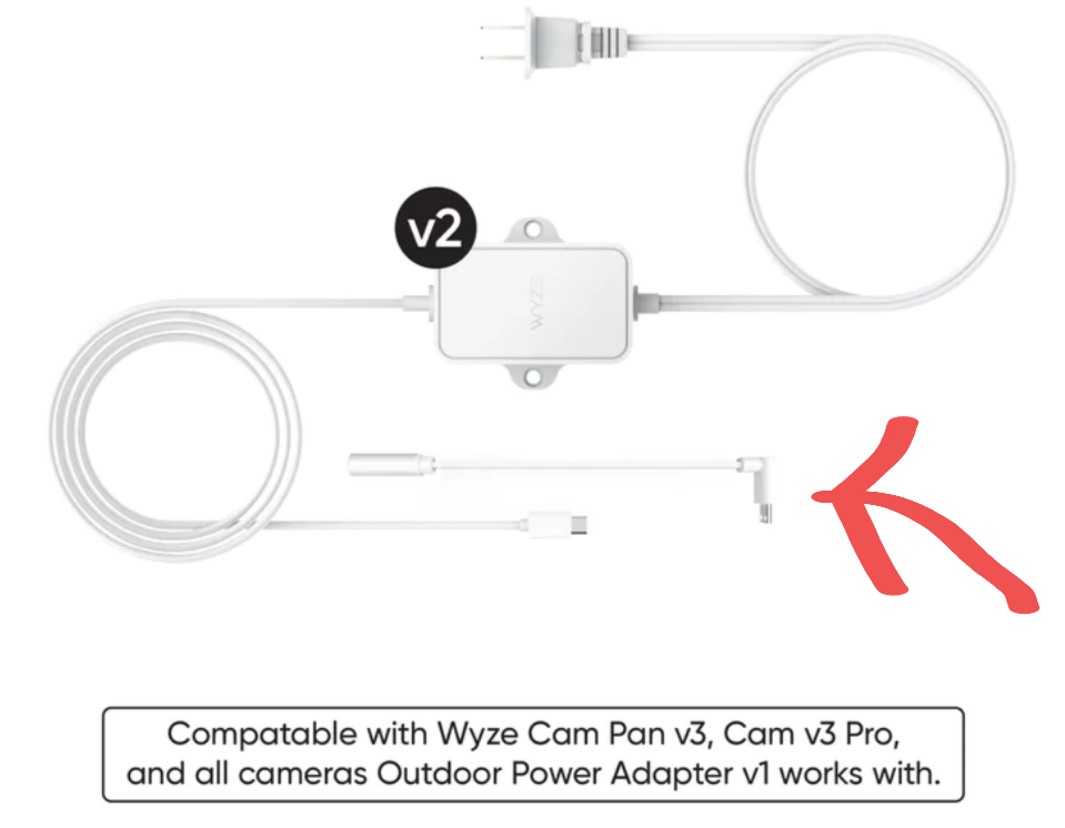

Going to order a bunch of OG now And maybe the new cam pan V3, once they sell or figure out how to extend more than 6 feet cable length.
I understand it’s a 90゚ angle end. But can’t find any photos actually showing where how the cable connects!
I have been reading on the OG threads. The regular cam and the telephoto are being sold seperately and the stack mount kit is also going to be seperate. May want to wait till that comes out to get them all at once. Maybe they will offer a combo kit with the whole shebang together??? Some have ordered a 2 pack thinking it was one of each when it is two of the same.
The 90° end is what connects directly to the cam. The other end of that 6ft cord is a standard male USB-A that plugs into the 2amp power adapter. A standard USB Power Cord Extension should work.
Definitely don’t focus on that. It is part of the waterproofing system; you don’t want to replace it. Like @SlabSlayer says, just use a standard USB Type A extender cable:
Wow look at you with the 90° photos, I couldn’t find any Thanks. No personally knew it was a two pack of OG not one being tele. Is that a fixed tele, or zoom and is it is a zoom I’m sure not optical by digital. Isn’t there a 3rd party USB A Female to a USB A to extend length be better than a bulky ex cord?

I had it recommended to use an ‘Active’ USB Extension cable. I bought and used one when installing a new Wyze Pan Cam v3 for my parents last weekend. It worked very well. I was told the Active cable would help with power over a longer distance. Thus far it is working very well.
Thank you!! I just ordered this for our WYZE Cam Pan V3. Is this brand new? I could not find anything like this earlier this week.
It looks like the 90° “Pigtail Adapter” that will allow connection to a microUSB extension cord is now available in the Wyze Store.
Unfortunately, it is only available when purchasing the Wyze Outdoor Power Adapter V2.
If you scroll thru the pictures to the right, #7 of 7 will show you the package image:
