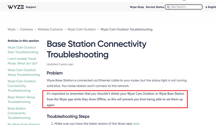

I had trouble with two of my Wyze cam outdoor camera. They were set to the office base after charging them fully they were having a hard time connecting. So I deleted them from office base tried to re-pair to the base and it will not connect. Is there something I have to reset or something else to do before I can get these working again?
So I have two cameras that I cannot reset? And a base station that cannot be reset? That’s crazy.
I agree but it has been that way since the base and cams came out. I have a Base and four WCO version one cams still working. I have posted numerous times that WYZE should have put a warning in the directions that came with the cam/base, There have been many people that have posted here about the same issue off killing off their cams or base. It is supposedly a safety feature, if someone steals you camera they can’t set it up on a new base. The fine print says you have to delete the cams/base from your account while online. ![]()
