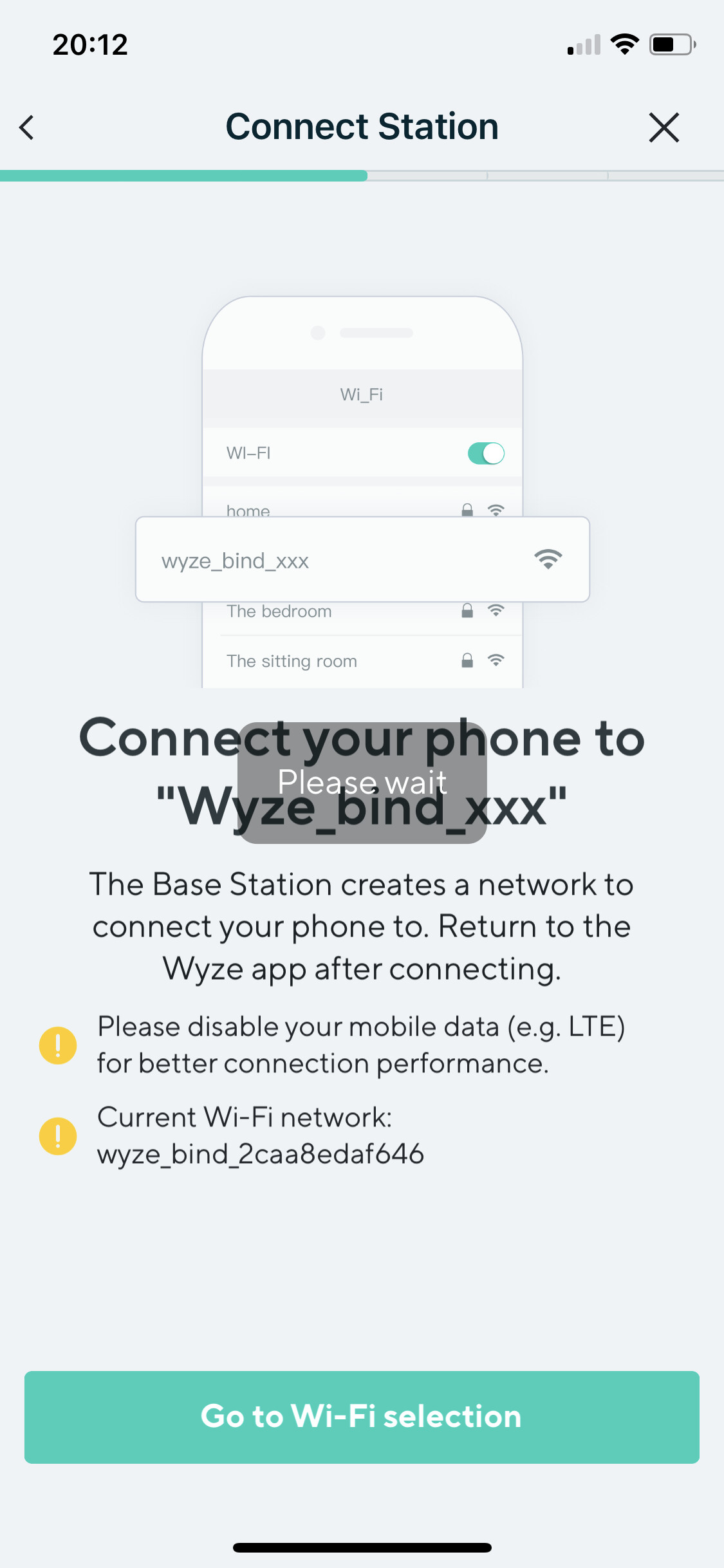

So today I finally received my Wyze Cam Outdoor. I was so excited to try it out but I’ve been trying to connect the base station for a few hours now without success. I’ve followed all the online instructions, The base is connected directly to the router via Ethernet cable and the blue light is solid. I’m stuck on the the page shown on the attached screenshot. It keeps saying “Please Wait” after I switch to the base station WiFi as directed and then it does nothing. The page stays the same and does not advance to the next step. Can anyone help?

Try turning off the cell network on your phone and trying again.
Because the signal from the base station doesnt connect to the internet sometimes the device will use the cell signal instead of the wifi which wont work.
Yes Your iPhone WiFi must be connected on the same sub-net as the wired Wyze Base router. You don’t want to connect to private Wyze network: wyze_bind_2caa. . . . .

@wpopp No it didn’t work. When I select my wifi network and go back to the app it does nothing. When I select the Wyze_bind network it at least shows “please wait” but still nothing happens. I’m still stuck.
Think you need to start over. Unlpug the Base for a few minutes. Your phone should remain on your WiFi network then scan the QR code on bottom of the Base and watch display on your iPhone.
Move the phone in/out from the camera until it gets a good focus. You’ll see a line sweep across the QR code and it will pair with the Base. There is no time where your iPhone would connect with the wyze_bind_2caa. . . network.

Thinking the instructions mean to connect to the Wyze_Bind_xxx in the Wyze App (not the iPhone).
I have tried to connect both by going through the steps and also by the QR scan and it always just stalls at the same screen as he posted.

I found a thread that said it is the new IOS 14 that is the problem. It says to try an old phone or old iPad and it should work. I am going to try mine tomorrow.

Yes, thanks @wpopp! I tried it on a phone running iOS 13 and it worked!
Hey good deal guys thanks for all your help. I just tried mine on my iPad and it worked also.
