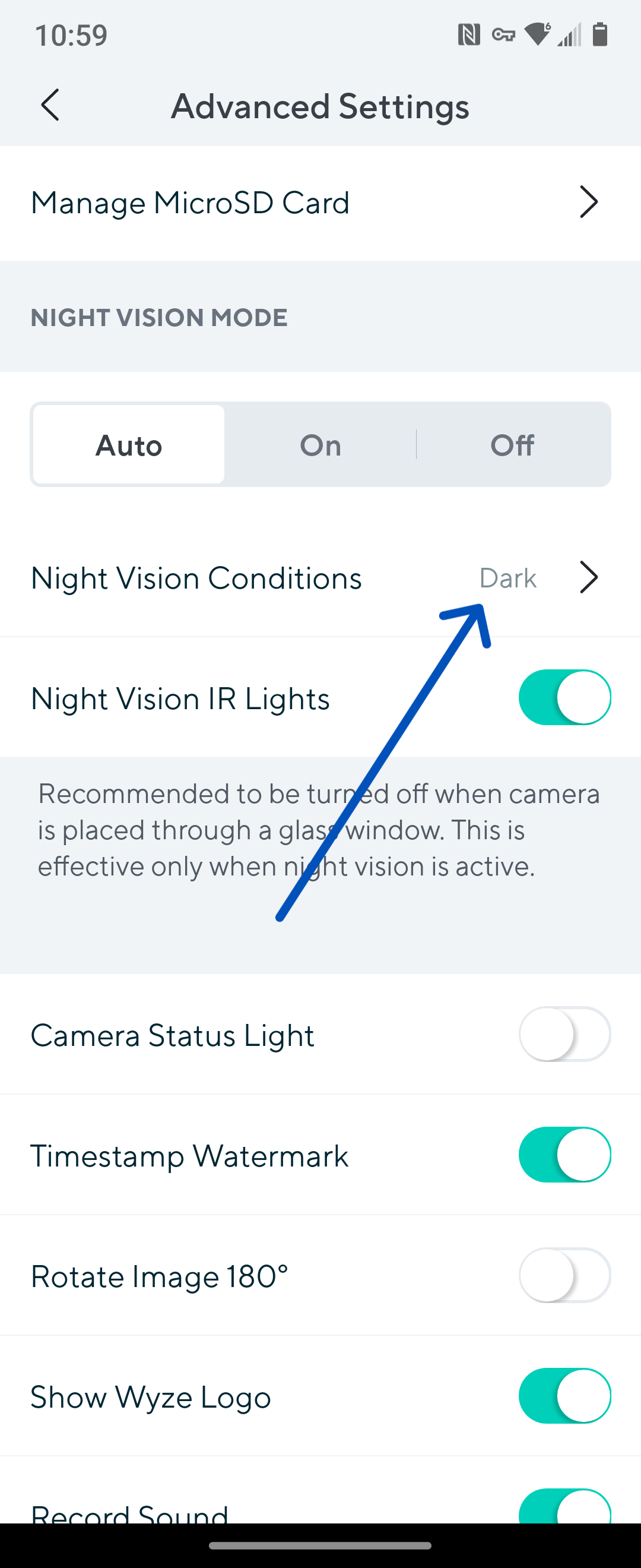

The Dusk or Dawn is under the Advanced setting:

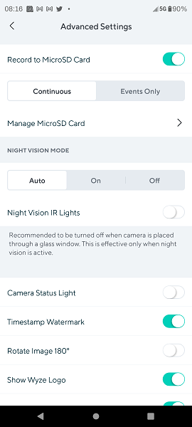

That’s what I was expecting. Not there. This is my only OG that is in Auto:
Can you verify your Firmware version?
Also, have you tried restarting the camera, power cycle? The only additional thing I did was add an SD Card, but that should not have made a difference
Confirmed on all the OG cameras that they have firmware version 1.0.67. One of the cameras is normally locked in night mode, but I changed it to Auto, and the Dusk/Dark option did not appear. These first two do have 64GB uSD cards installed and set to continuous recording. The third OG is normally locked to daytime mode, but I changed it to Auto, and again, the Dusk/Dark option did not appear. This camera does not currently have a uSD card installed. My 4th OG is still in the box…
I’m 26 miles from the two cameras at home and about 35 from the one at the radio site, so no ability to power cycle them until tonight.
I should note that these are all OG-Tele cameras, but I would not expect the different lens would affect this function - but you never know…
Interestingly, my Standard OG shows the Dark / Dusk option. The Telephoto does not.
@WyzeAndy @WyzeJasonJ
Can either of you confirm that the OG Telephoto is supposed to have the Dusk / Dark Option?
My OG Standard shows the option but the Telephoto does not.
