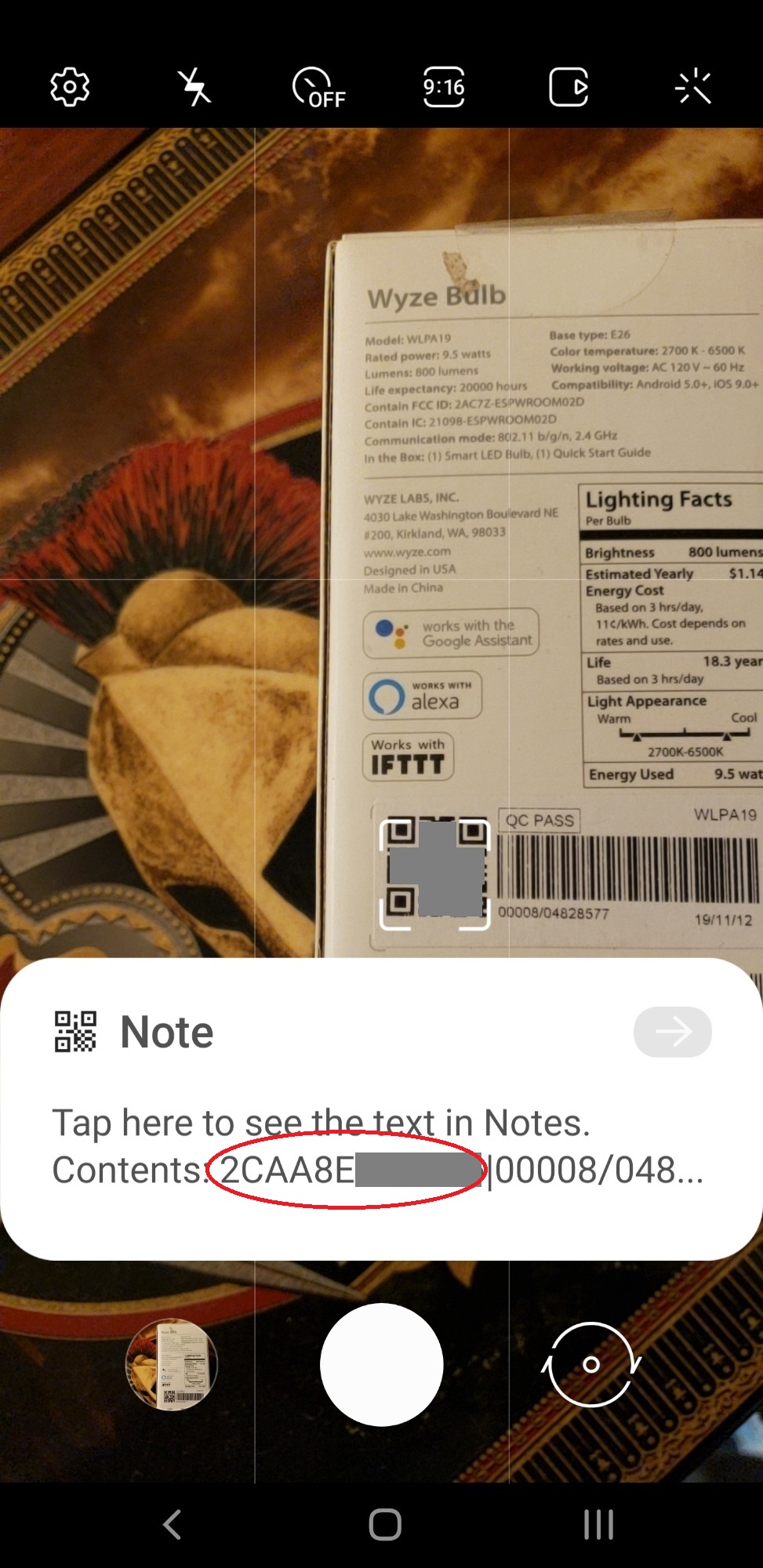

The MAC address is encoded into the QR code on the back of the Wyze Bulb box. If you scan the QR code with your phone, the 1st group of 3 numbers/letters (12 characters long) separated by pipe symbols (“|”) is the MAC address.
Edit: Added photo.
Hi, I know this is a bit late but hopefully it will be helpful for others in the future. The QR Code on the bulb itself holds the MAC Address of that bulb. You will see a QR Code on the side, scan with a phone and you’ll get the MAC Address. I just had to go through this with a few students at the University I work for.
Folks wanted the bulbs in their dorm rooms and we require devices to be added to the network by MAC Address so this question lead me to looking at the bulb and after reading the part about scanning the QR code on the box for the MAC Address,
I scanned the bulb QR Code because the one on the box, if it gives a MAC Address, it’s not for all 4 bulbs in the box (Unless you bought 1 bulb only, then that QR code would most likely give you that info.) Thanks for asking the initial question which got me on the path to finding the answer to my scenario :slight_smile:
