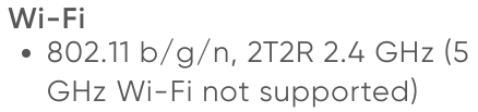

Also remember that Wyze uses 2.4 GHz and 5 GHz so when you check the channel, check the congestion on those bands. However, the V3Pro is only 2.4 GHz.
