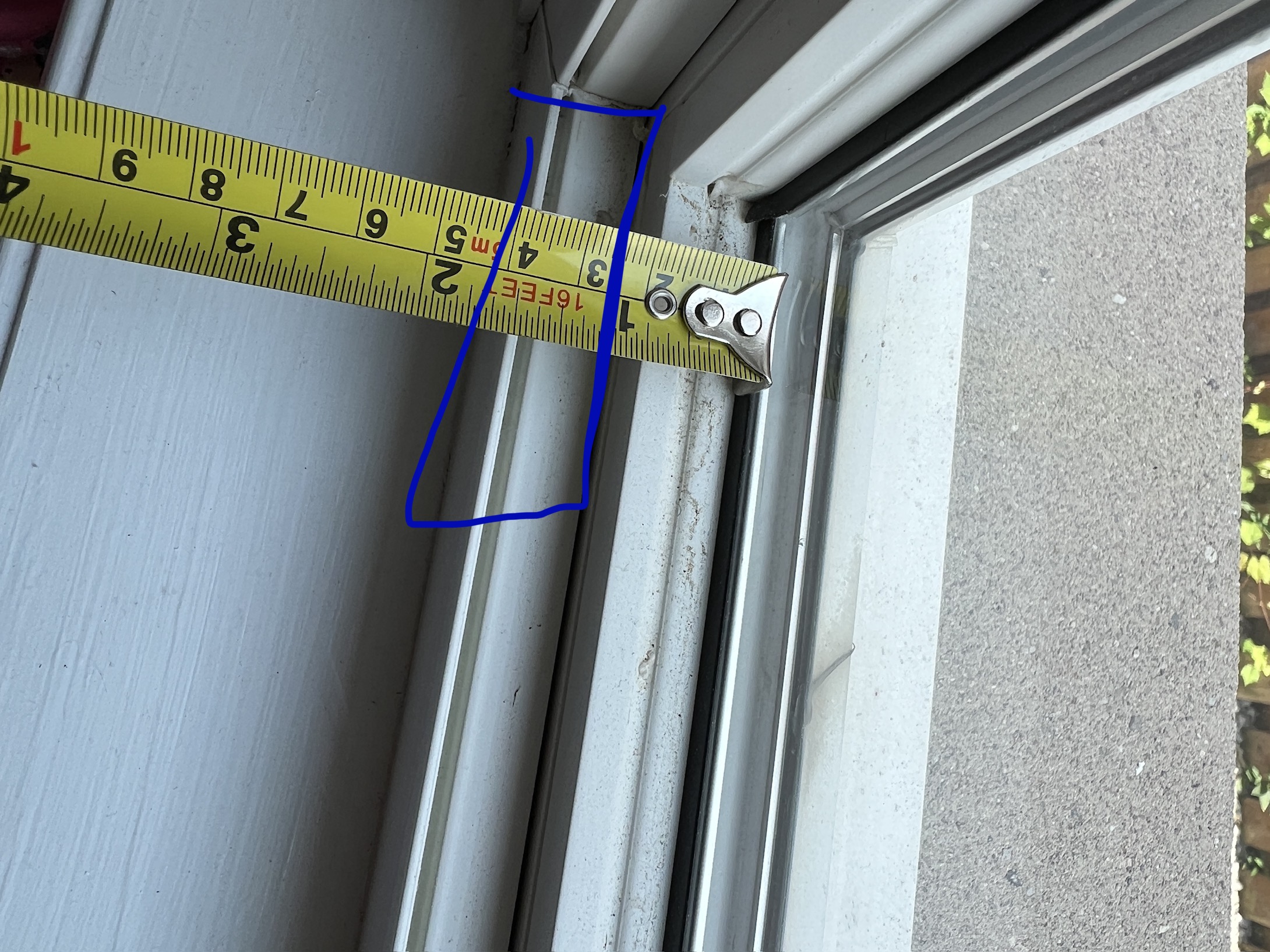

The measurement with the tape measure appears to be from the left hand window without the screen.
The sensor is ~15mm thick. Is there 15mm between the screen frame and the sash frame?
Yes coz I couldn’t put the measuring tape in with the screen on.
So the groove where I highlight in blue is where the screen slide in.
But because the screen also has its own thickness. So that also take up another 1/4” or so.
Not enough then. I took a look at the first shot. The magnet looks like it is wedged in the space on its side, so it isn’t enough room if it were to be rolled 90° since it is taller than it is wide. This also means the sensor won’t fit…
The only other option I can think of is if the sensor was narrow enough to lay flat on the sash bottom sill against the glass with the groove toward the screen and then stick the sensor groove side directly to the screen on the inside (screen between the two).
Would it work to take out the magnet so that it is easier to squeeze in there and then use double-sided tape or something to hold it in place.
