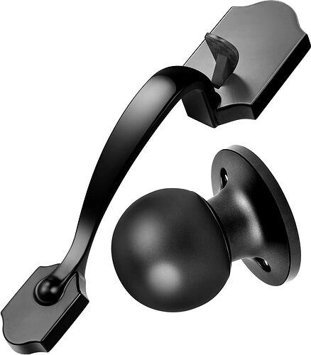

I personally have no preference but my wife prefers handles as she suffers from debilitating arthritis and has a hard time turning knobs. We’ve replaced all knobs in the house with handles.
This is what I used and it matches great.
[Mod Edit]: Fixed broken product link.
My comment was about different finishes for Palm Lock to match the finish of hardware that someone might already have on the door, but I can see you went the other way to get your door hardware to match Palm Lock. :grin:
That probably makes more sense, actually. Changing Palm Lock’s finish might detract from its Sith-esque æsthetic.
