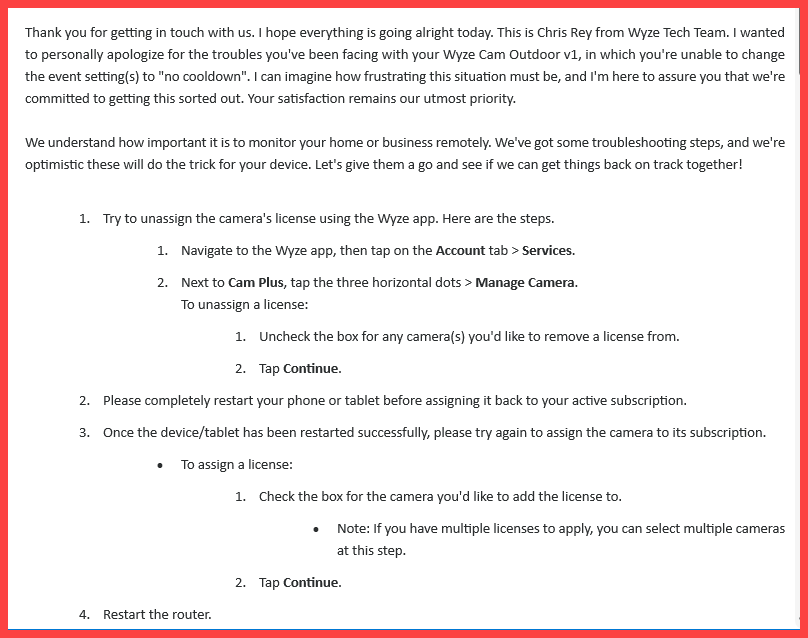

They are asking me to do the following to attempt to resolve this issue,
Is Wyze really not able to duplicate this issue in house? I find that hard to believe, and assuming that is the case, I find it annoying that I’m being asked to waste my time performing these steps for an issue that should, by now, be easy to create in house and also should of had a solution for by now.

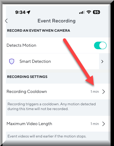

WCO v1 - Event Recording - stuck on 1 Minute Cooldown
Why are my Wyze Camera Outdoor V1’s still not letting me set the Event Recording Cooldown to “No Cooldown
All Eight of them, I change them to “No Cooldown”, the revert to 1 Minute. This is making these camera’s useless. I’m paying for Cam Plus on these Cameras.

I believe that is because they are battery cams their minimum is 1 minute, but someone can correct me if I’m wrong.

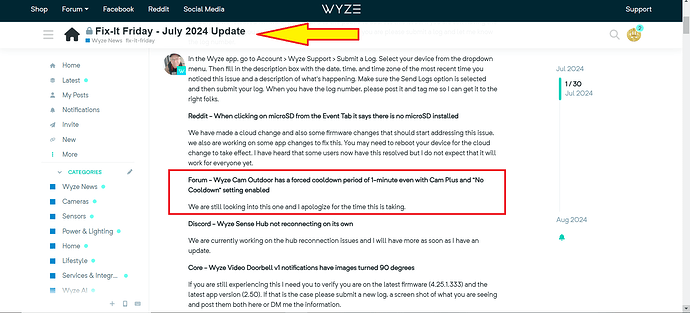

@CatHome The issue of the 1 minute cooldown started 6 November 2023 and was caused by a firmware update. WYZE definitely knows about it since at first they said the could not replicate it then they said they could and they would work on a fix that has never happened and never will. There were hundreds of support tickets sent in including four of mine that all got closed. The issue was listed on the Fix it Friday list for 6-7 months before that went away.
If you want no cooldown you have to put an SD card in the cam, set it for scheduled event recording, set for 30 days, MOTION ONLY, No Cooldown and a Max duration of each videos up to 5 minutes. You can record cloud events and to the card at the same time. The camera will record to the SD as long as motion continues.
