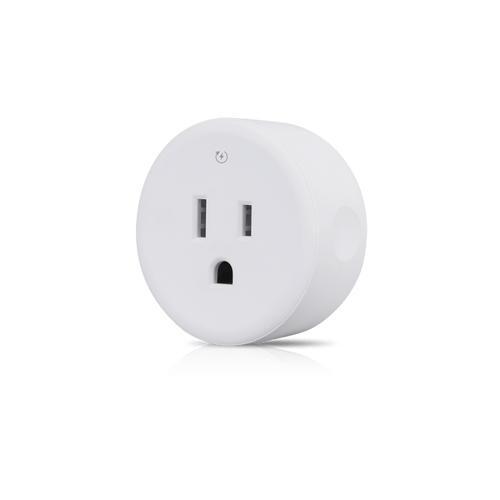

For all of you folks out there who are using smart plugs (no brand specific) to reboot your routers/modems on a schedule. Beware of prolonged power outages, they will render the schedules useless.
What happens is that if there is a prolonged power outage including internet, the internal clock gets “confused” and will not run the schedule.
I have Kasa plugs that they “remember” last power state, powering three v3s and a router/modem combo on a schedule at a remote property. There was a power outage for over ten hours few days ago, and now =none of my cameras and plugs are reachable. It looks like the plug in front of the modem/router got stuck in OFF mode as the clock lost time and didn’t get updated via internet.
I was told that another outage might reset the plug, but that is not guaranteed.
Just beware.
Most of the smart plugs are not reliable enough (in my opinion) to use for any kind of router management. The problem you posted is just one of many. For reliability a simple “clock” type timer to reboot once per day (or less often depending) should be enough to keep your home network and router functioning. There are also products that connect to the router’s power supply and will power cycle the router if the device cannot reach some server or URL on the internet.
One or the other should take care of most issues.
I learned the hard way, that is why I’m posting, to warn other users.
That is the route I’m taking, or get rid of the schedules and manually reboot the router when needed.

Do you mind pointing me to one of these devices? Thanks
Only did a little searching:
https://a.co/0hMk9DA
Thank you guys. I think I’m going with a timer plug, have a feeling it might be more reliable.
