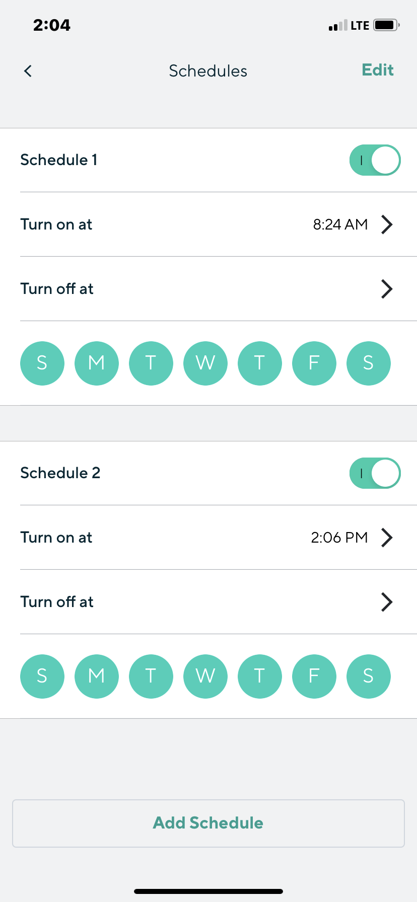

I am attaching a screenshot of how I have set up my Wyze plug schedules which the camera is attached to in order to assure that the camera turns on at least twice a day if it had been disabled. Do I have it, right?
These are just turn on schedules. If your cam is already powered on but is just offline (WiFi not connected to the internet), that means it has power already. Turning on the power from the plug to the cam that is already on won’t achieve any results.
You need to have a “power cycle” in the schedule. Turn off then turn back on each time to force a cam reboot. This schedule will run so long as the plug has power, even if it is offline as well.

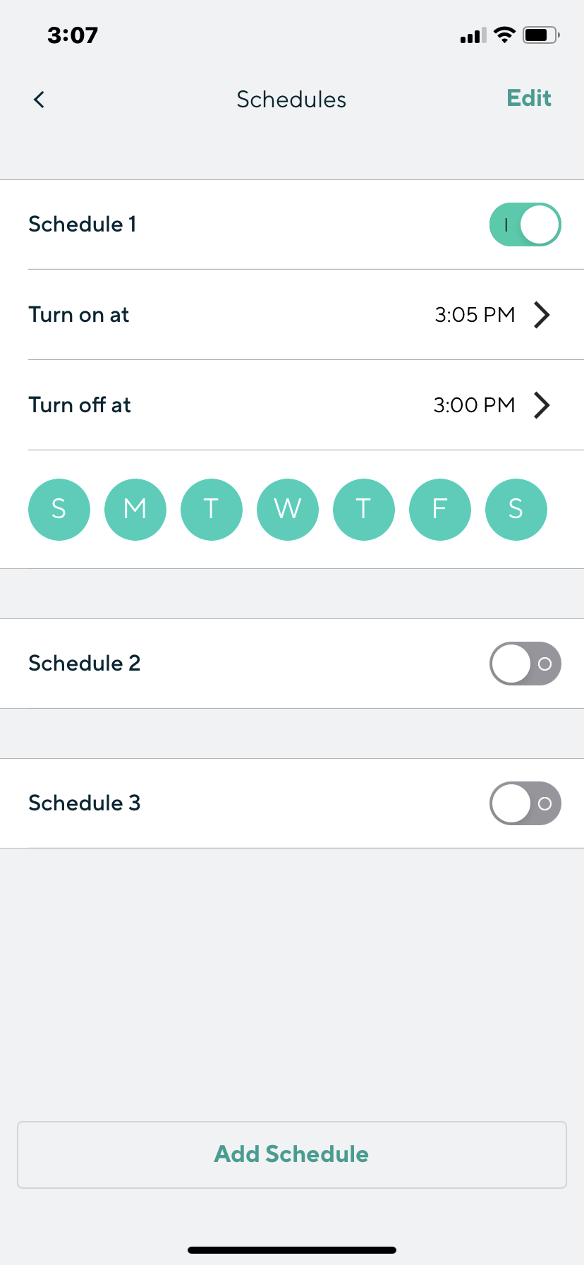

Let me summarize the test I just ran:
I set a schedule for my smart plug (with a V3 plugged into it) as follows; OFF at 3pm, ON at 3:05pm.
When 3pm rolled around the smart plug turned off. Additionally the V3 disconnected.
When 3:05 rolled around the plug turned on. Additionally the V3 turned back on but only after I initiated it.
Did this accomplish the same purpose as unplugging then plugging back in the smart plug ?
If so, (even though this is a workaround) I see that It would get my cameras back on if they disconnect when I am away from home.
If the above is true I could set LOCAL schedules for each of my 5 cameras several times a day and be able to continue to use them even if I can’t get home to reset them. Caveat being that I would need to notice the cameras may have gone off and reset by schedule and I would need to restart them as required.
Have I got this right ?…tlhutch4
You don’t have to leave them off for a long time. 1 minute off should still do the trick.
If the V3 Cam was powered on when the plug cut the power at 3:00, it should have returned to the on state, logged into the network, and shown in the App Device List as green. You shouldn’t need to initiate any power on.
If, on the other hand, the cam was off when the plug shut off, it will return to the off state once power cycled.
No. What you have programmed in the schedule is the same thing as unplugging and replugging (power cycling) the cam, but not the smart plug.
When you power cycle any device, you force it to reboot and log back into the WiFi router to be issued a fresh IP address. In your case, your cam has a fresh IP, your plug does not. BUT… The plug going offline is not so much of an issue unless you have to do a manual power cycle on the cam. Even if it does drop WiFi and go offline, the schedule will still run and power cycle the cam since it is saved locally.
Yes. You should only notice this behavior if it does it while you are streaming or expecting motion activations. I wouldn’t think more than once a day would be necessary. If you have to do it more than once a day to keep them online, you have a significant network issue that needs solved.
As I mentioned above, if the cams are on when power cycled, they should return to on. You shouldn’t need to turn them on. You do have to give it all time to report back to the app. It isn’t instantaneous. You may even need to refresh the device list by pulling it down or closing and reopening the app so it can pull a new status from the server.
If you are seeing in the app the cloud symbol with the line thru it, the cam did not turn off. It is still powered on, it is still recording to the SD Card, and if you click to open it there is a distinct possibility it will still stream (a bug Wyze is working on). The cloud symbol just means there is a broken WiFi or internet link between the cam - the router - and your app (usually the WiFi). If you see this and can still stream the cam, Wyze wants SD Card Cam Logs submitted. If you can’t stream, that’s when you can manually turn the plug off then back on to power cycle the cam. If you find that the plug is also going offline, you most probably have some network connectivity issues that need resolved.
