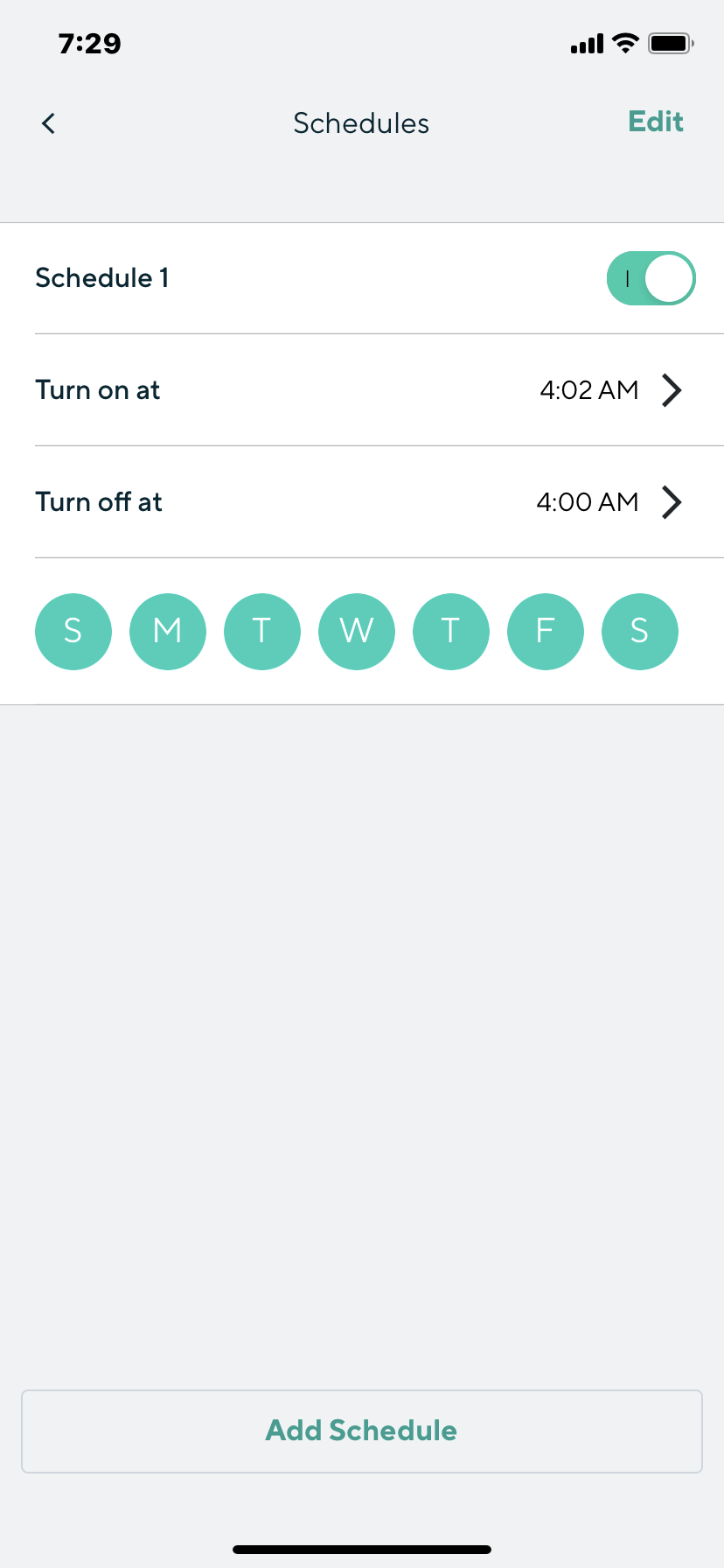

My Garden lights prior to setting a schedule for a 2 minute downtime at 4am worked perfectly- ON at Sunset then OFF at 10pm.
Noticed yesterday and today with the 2 minute downtime scheduled at 4am my garden lights came back on at 4:02 following the 2 minute downtime. Wondering why that would happen. Any ideas ?
The Smart plug noted in my previous post has both a Schedule and a Rule;
Rule- turn on lights at Sunset and OFF at 10pm
Schedule- Turn OFF the outlet at 4am and back on at 4:02am
Doesn’t seem like this a conflict which is why I’m wondering why the lights turn back on at 4:02

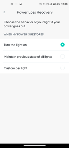

If you are using this two minute power cycle to refresh the IP on your smart bulbs like you do on your cams, you need to go into your bulb settings to adjust the “Power Loss Recovery” (screenshot below is for a group).
Because your plug off\on sequence at 4am forces a power outage for the bulbs, they need to be told to return to the prior state in case of a power outage. I suspect they are currently being told to return to power on.

Because you have lights plugged into this plug, that do not need power cycled, the following happens:
Lights go on by rule at sunset
Lights do off by rule at 10pm
Plug turns lights off by schedule at 4am (they are already off)
Plug turns lights on by schedule at 4:02am

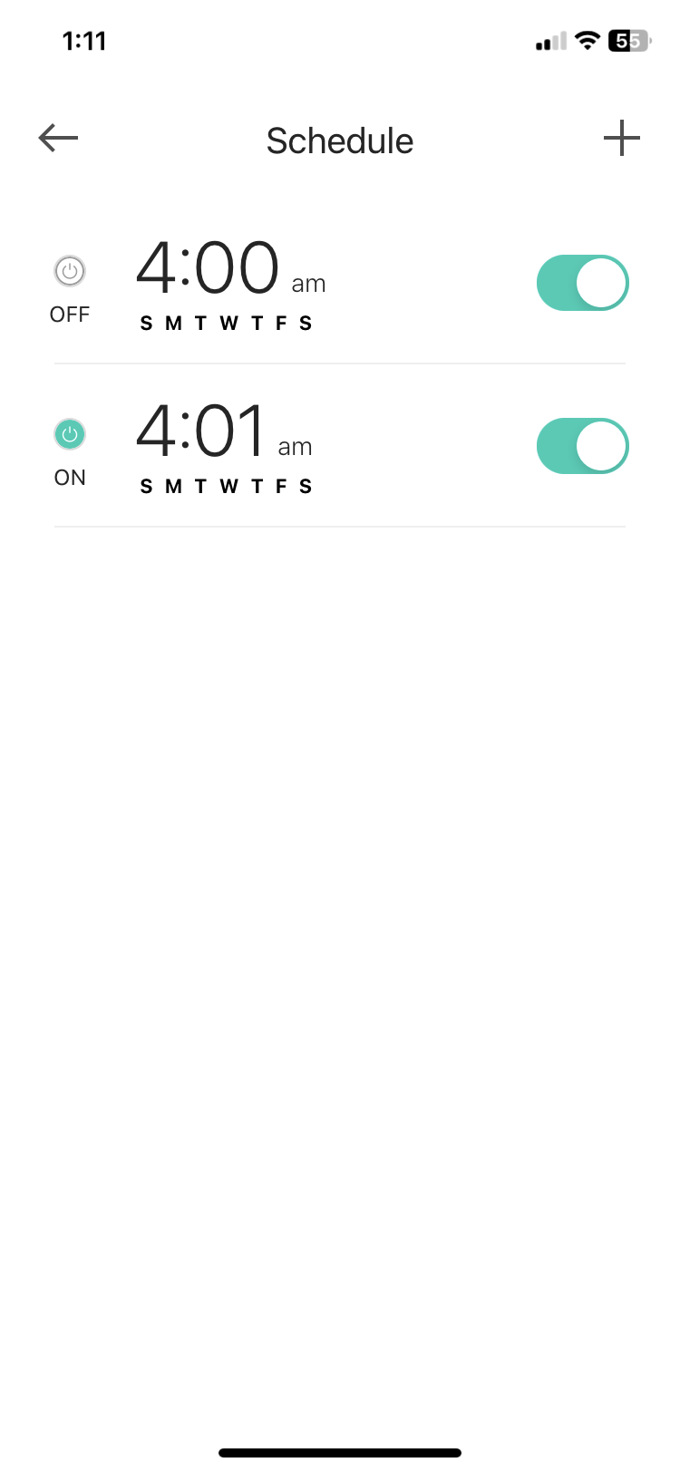

Am I correct in assuming that Wyze plugs do not store schedules and rules locally? I don’t own Wyze plugs so I am clueless.
SabSlayer, Thanks again. You nailed it as always.
I wasn’t even aware of there was a “Power loss Recovery” setting. Just fixed it per your instructions. Should be correct tonight and restore my garden lights to prior setting before the power cycle.

I suspect that, based on the schedule screenshot you posted, that your plugs may be similar.
