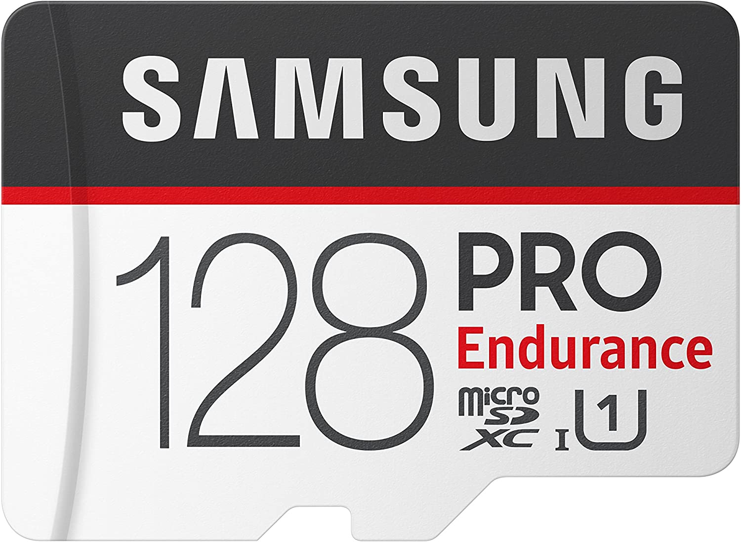

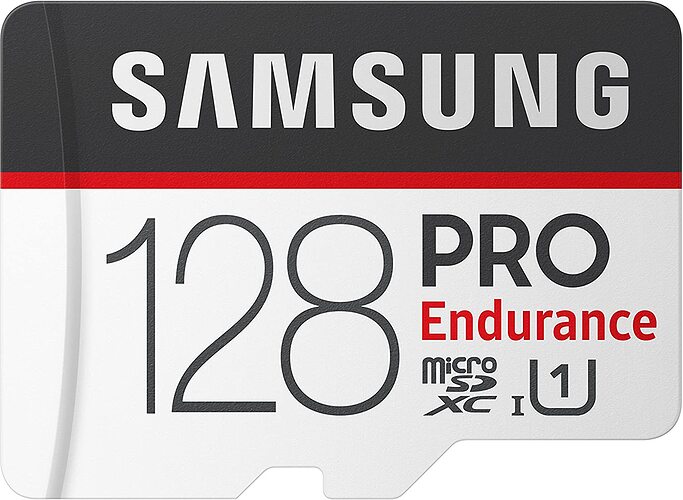

Just a heads up on the SD cards, for this use case scenario the ideal would be an endurance rated card…these are built for surveillance cam type situations , while the Samsung EVO is a good card (I have one in my cell phone and it works great) it is not the recommend card for this application. Below is a link to Samsung Pro Endurance cards that are built for this high demand video recording, I am currently using the 128GB with no issues - disclaimer - only cards up to 32GB are officially supported by Wyze
