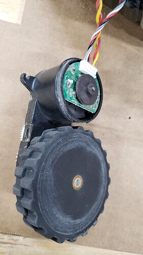

I removed the wheel as attached picture. As long as i can find the motor, I should be able to replace it. Does anyone know where to order or part number?
I’ve seen the motors (similar design) in the $10+ range. I recommend replacing as an assembly.
