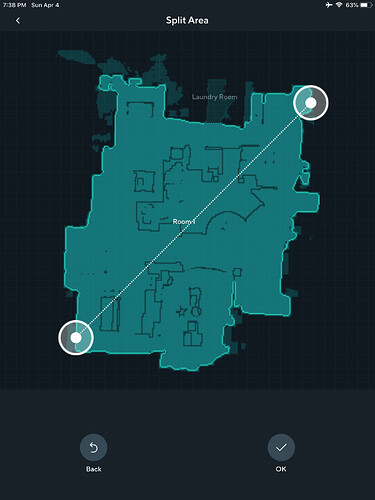

same here. I cannot split using a horizontal line. The end point jumps up to the top right corner or bottom corner of the room.

I have iOS with the same problem. The vacuum only recognizes walls that are continuous with the perimeter. Any wall not attached to the perimeter are treated as a piece of furniture and will not allow you to anchor to it in the map editor.
Just adding my name to the list of people who canât anchor to interior walls. This is frustrating because literally every room of my house except for one is defined by interior walls, so my house is divided into âLaundry Roomâ and âEverything Else.â I hope thereâs an update soon.
I too am having issues not being able to pin to an interior wall. It seems to assume the walled area is just an object/obstacle in the room (like furniture) not an actual wall.

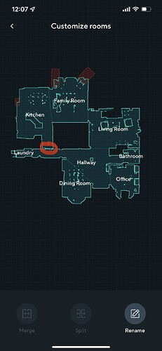

I also had the problem with splitting on interior walls. I discovered a âhackâ that some of you may be able to use to making the splitting work a little better.
My house has the stairways and pantry in the middle of the house, and the app would not let me split on the walls that are a part of that. I built a âtemporary wallâ using the empty Wyze boxes in one of the doorways while doing the mapping. This caused the app to treat the interior walls of the stairway as part of the perimeter, and I can now split on them. The fake wall is circled here on my map.
