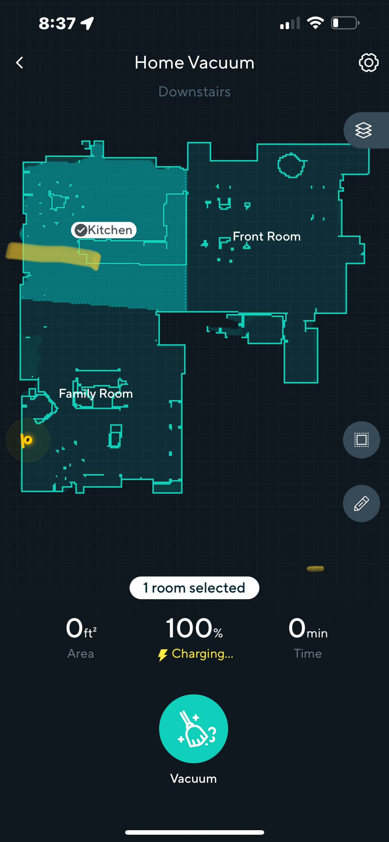

Ok, this may be my issue as well. It isn’t a HUGE issue for me, as I can mostly make the rooms right but it won’t let me divide the kitchen where the tile ends. It means if I tell it to vacuum the kitchen it vacuums a larger area than needed, so I’d like to fix it if possible. It DOES let me put a wall at the narrower opening, but not at the larger one. If I put some boxes/cardboard at the narrower opening (easier since it is smaller) would it let me then separate that room off? Or would I need to block the wider opening? And how tall does the barrier need to be, I wonder? I want the room to end where the yellow line is.
Thanks for your help. I’ll try that this weekend.
I don’t think it matters which side you block off, but if one doesn’t work, you might try the other.
As far as the blocker goes, it needs to be high enough to completely block the LIDAR sensor, and strong/stable enough not to be bumped over.
