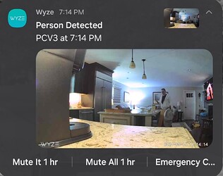

just tested this on my Android Device, Seems to be working fine on that so it may be an issue with iOS.
Here is what I see on Android:
@R.Good @carverofchoice @cyberdog_17
I cannot test on my iOS device at this time, can one of you check on iOS if there is an issue with the PCV3 with the notifications missing the action buttons?

Looks like it is there but you have to long press on the notification for iOS.

I tried the long press and it didn’t work I just update to the new iOS and this is when the problem happened
What Wyze App version are you on?
I am on iOS version 17.5
And Wyze version 2.50.0 (14)
I have 2.50.6 (1) for Wyze
And 17.5 for iOS
Ahhh yep… I match you now and totally gone.
@spamoni we got ourselves a :beetle:
Also not an option on V4, FLV2, FLP.
Not sure if iOS 17.5 broke it or if an issue with the Wyze App. Going to assume lastest Wyze app since I had an older Wyze version with iOS 17.5 and it worked.
