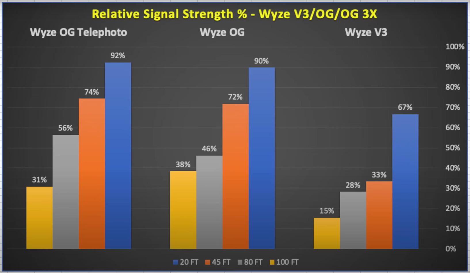

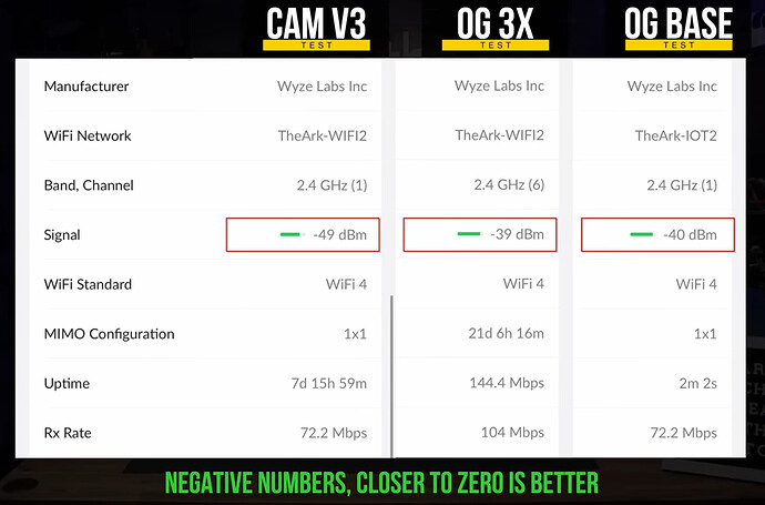

@TheNetGuyDotCom did some good comparisons related to this:

Thank you. Good video. The wifi antenna seems to be much better with the new OG camera. Now I am eager to get back to the house and install a new OG and replace the V3. I like the new OG setup of no scanning a QR code. At times, it can take a couple of minutes of getting that step to work.
