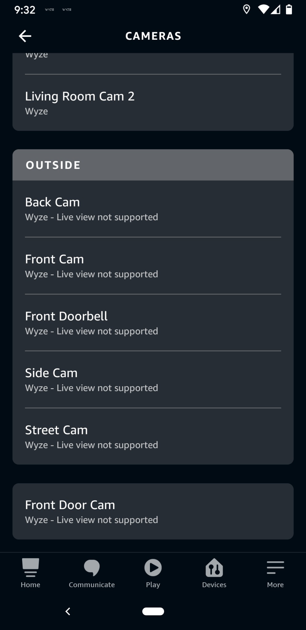

V3 Does NOT work with Alexa
I bought the v3 camera specifically for the “Works With Alexa” feature. It does not work with Alexa. In the Alexa app, the camera has “Live view not supported” written next to it. If trying to connect from Fire TV, Alexa reports no connection.
Has anyone connected a v3 to Alexa and viewed live footage?
Thanks

Thi means it can’t be viewed in the Alexa app. More discussion on this here:
Yes… When you add the WYZE Skill to your Alexa App, you can view your V3 camera(s) from the variety of Echo “Shows”, Fire TV (The cube), and Fire Sticks (Must be paired with an Echo dot)
As @Brlepage provided. The V3 is not able to be viewed in the Device List under the Alexa App installed on your phone, just yet I am sure Amazon will add it but who knows when… BUT! If you have a newer version of the HD Fire Tablet you can view the V3 live from the “Device Dashboard”
