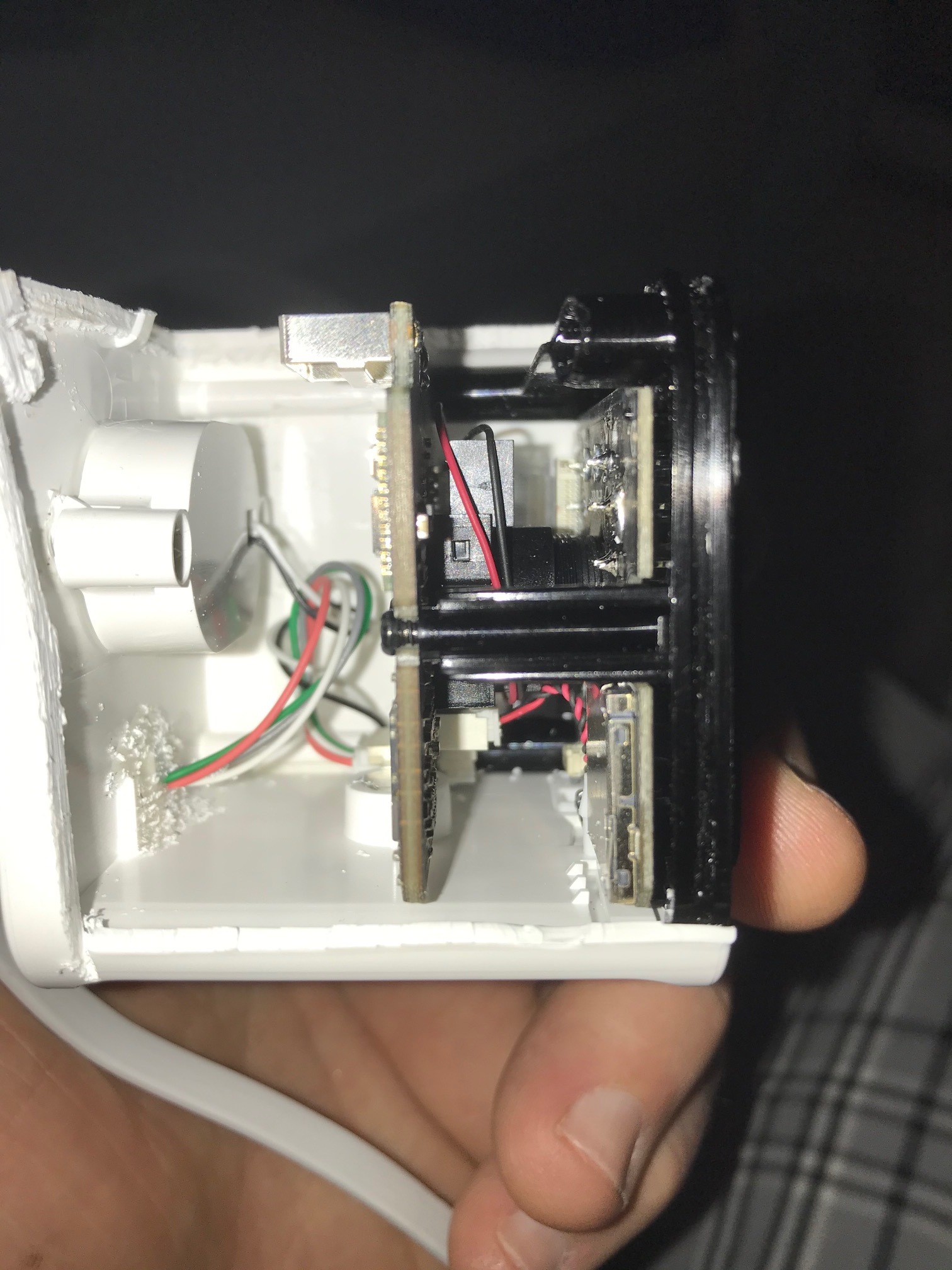

Thanks…Not holding my breath. I took one apart to look for the antenna to see if i could add a better antenna like you could with the old ones. Not sure if this metal piece on top is the antenna, but they definitely changed the antenna design, or at least I can’t find the antenna that looks like the old v2.

The fcc information available indicates that as the antenna.
