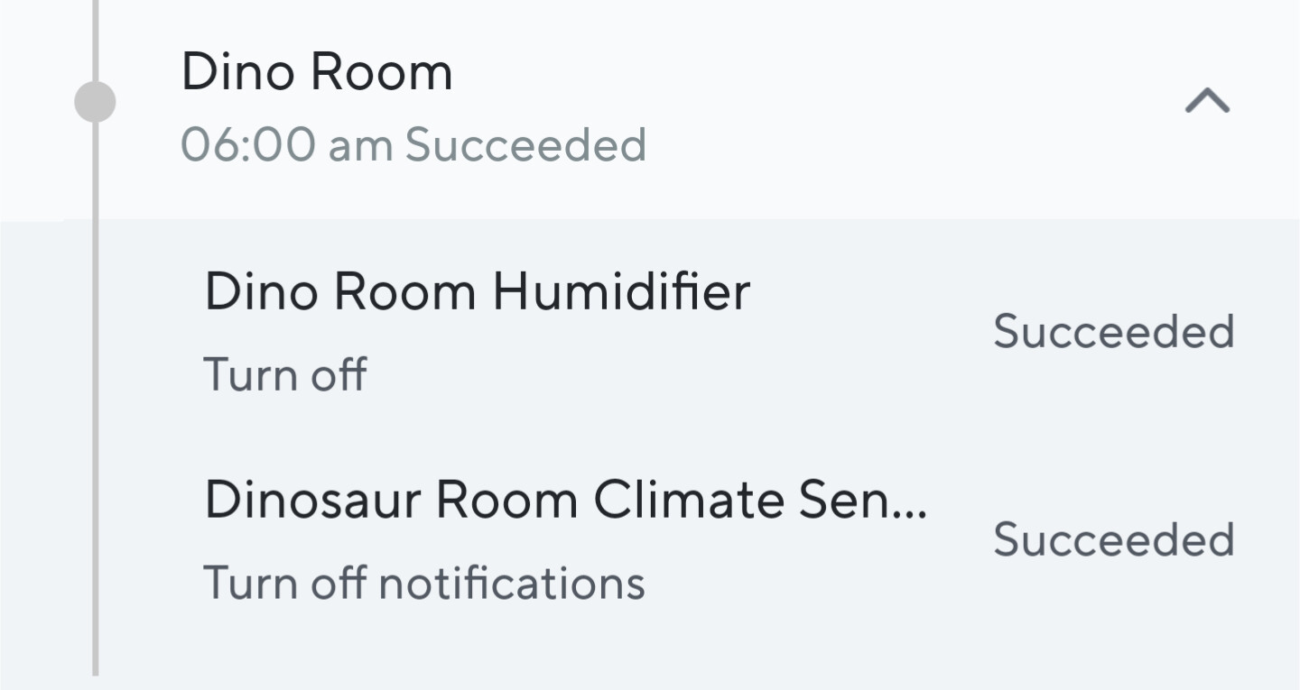

Interestingly the rule appears to have worked properly on schedule this time. There was at least one instance where the rule reported “partial success” and the state of notifications on the sensor was not changed, but I have cleared the rule history for troubleshooting purposes so can’t see that event now. So for now this does appear to be a display issue, unless the rule fails to fully work again.
Also interestingly, in the rule history the device name is shown properly. Only in the rule edit page an I seeing it as unknown.
