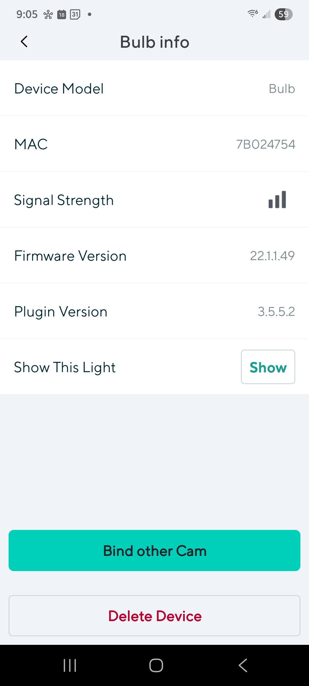

So, i’m having trouble updating the firmware for the accessory bulb that is paired with the bulb cam. I have been trying since yesterday, placing the bulb where i’m going to have it, then closer to the bulbcam, then inside closer to the router, and in other various places in my home. The bulb cam communicates to the accessory bulb, but no matter where I locate this bulb, no matter what wifi signal strength, the firmware won’t update. Anyone else having this issue? Is it time for a support ticket?

An alternative to moving them might be restarting the camera (Restart button in Settings) and/or power-cycling both devices (easy if they’re on the same circuit). I know that your screenshots are showing a good link (“Online”) between the Accessory Bulb and Bulb Cam, but occasionally I’ve seen an Accessory Bulb show “Offline” and power-cycle/restart often solves that for me. I’d probably try that first and then think about moving them inside for a few minutes if you can.
