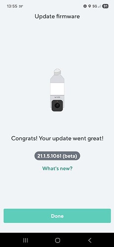

I’ll bite and ask this again:
Loaded on a Bulb Cam that uploads minimal daytime events, but uploads lots of nighttime events as it’s basically a critter cam running ambient light until critter or person is detected and that is an all-night affair. :joy: Will be monitoring and report any issues with logs.
Let me see if I can get that answer
So far so good. :+1: No connection errors. Got hundreds of events captured day and night. No errors. Spot on AI object detection, recognition, tagging and uploading with person and pet (raccoons, cats, kitten, foxes). Other stuff working great too like scheduled ambient light, timed 100% light on based on AI object selection, SD recording and playback, etc.
