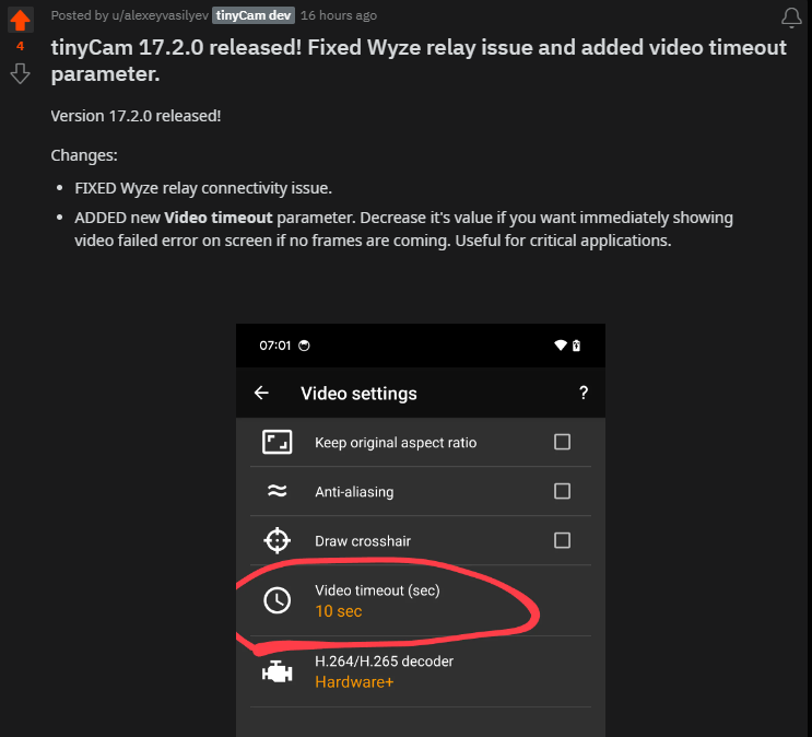

TinyCam dev announced Wyze issues are fixed in the latest app version:
https://www.reddit.com/r/tinycam/comments/1ag40iy/tinycam_1720_released_fixed_wyze_relay_issue_and/
