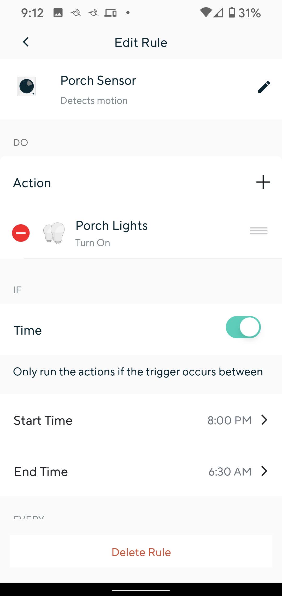

I seem to be having problems again related to Device Triggers Rule. I have a motion Sensor which is supposed to turn the lights on Mon - Sunday between the hours of 8pm and 6:30am EST. When I activate the sensor, no lights go on. If I turn the time constraints off, the sensor works as expected. Is anyone else experiencing this?

Ok - so I did my test again and found that it was indeed failing. I responded to the ticket I opened yesterday. But here is what I have determined:
Motion Sensor: When motion is sensed on the Porch Sensor between the hours of 8pm and 6:30 am turn the lights on. When Motion stops during the same period, turn lights off. (THESE 2 RULES DO NOT WORK).

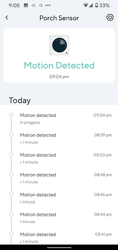

The Motion sensor is working as I do get alerted that motion has been detected and the Wyze app shows motion detected, see attachment. the Rule simply is not firing.

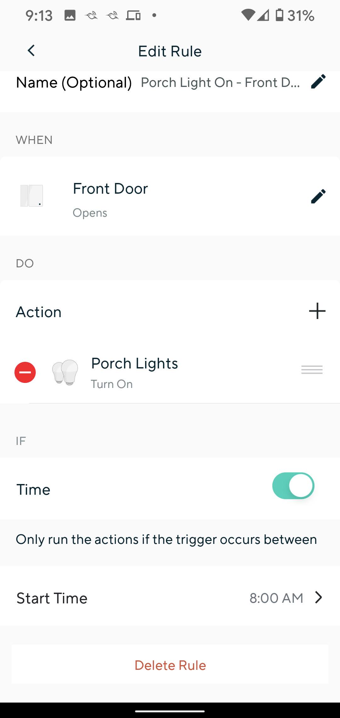

Contact Sensor: When the front door is open during the hours of 8pm and 7:00am turn the lights on. When the door closes during the same period, turn the lights off. (THESE 2 RULES WORK)
