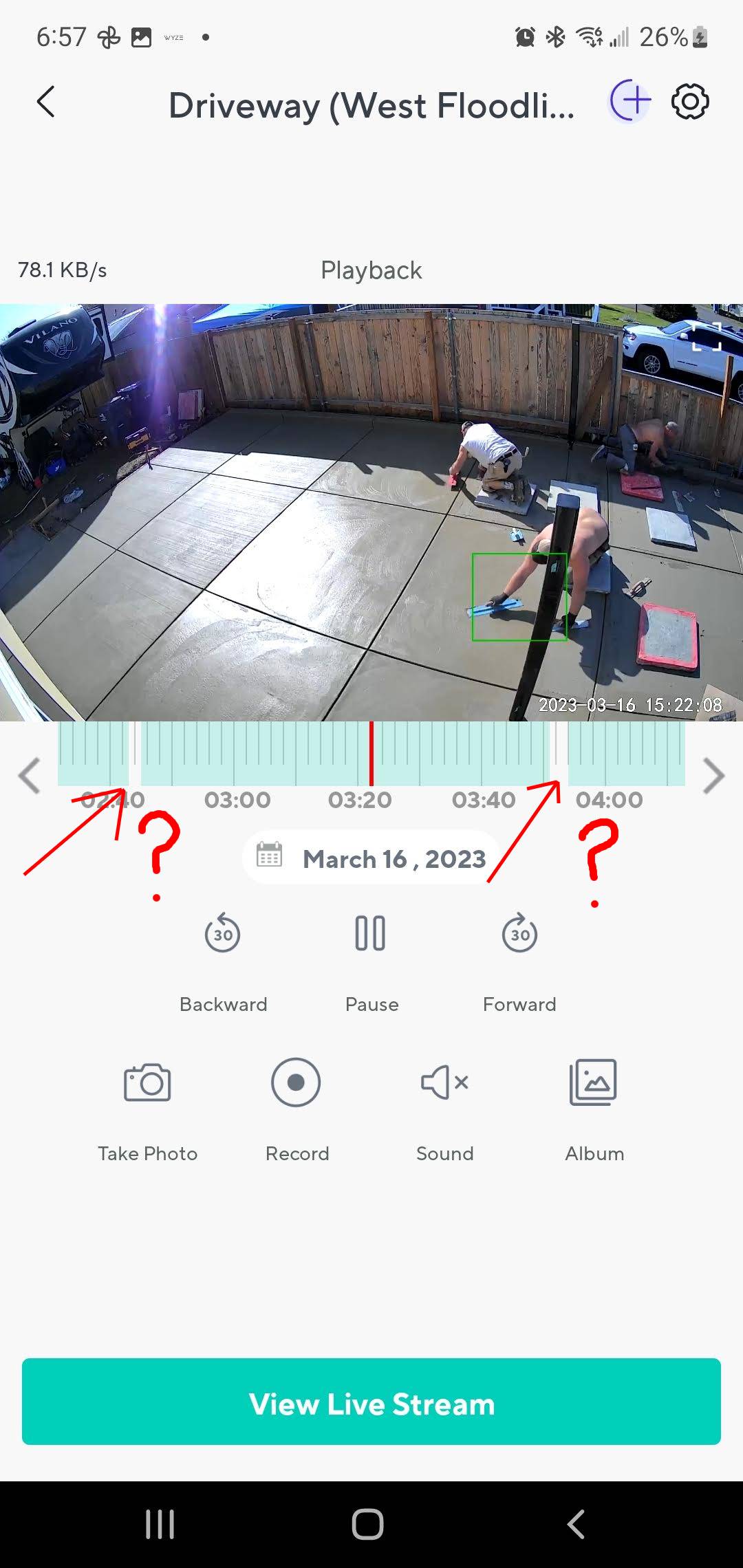

Hello, I set up a time lapse on 5 (three v3pro’s and two v3’s) of my cams to record from 7am to 5pm with a 10 sec interval this morning and it appears NONE of them recorded anything.

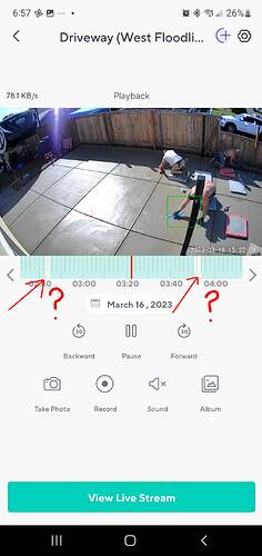

I did notice when I look at the recording timeline (I have them all continuously recording) that there are a few breaks in the recording, Could this cause the timelapse to fail the entire recording?
All of my cams seem to have breaks in the recordings too. My router seems fine, nothing else has had problems connecting to the internet…

I haven’t a clue unfortunately. I have two floodlights with the v3 that comes with it, and a v3pro connected via the USB outlet. It should have had constant power, but can’t verify that. The wifi bars show 2 of 3. I do get frequent error 90’s when viewing the live feed (i’ve been told, and verified that it is still recording even when not connected to the wifi) So I’m at a loss as to why it would stop recording randomly. Seems to be right at the start of a new minute too (if that makes sense?) the break is anywhere from 2-4 minutes total.

I did have one v3pro accessible. the timelapse WAS in there, but it was incomplete. It stopped short about 4 hours before it was supposed to. When I checked the regular recording footage (all the 1 minute clips) it appears where the timelapse stopped, was a corrupted file. The file wouldn’t play, and there was a missing minute after the corrupted file as well.

I was thinking the same thing after glancing through the footage. I started writing down when the interruptions occurred, but they were all at different times. I have 2 floodlights (4 cameras total) on the same breaker. If there was a power loss, wouldn’t they all restart at around the same time?
Also, I don’t have any rule that restarts the cameras at a certain time.
