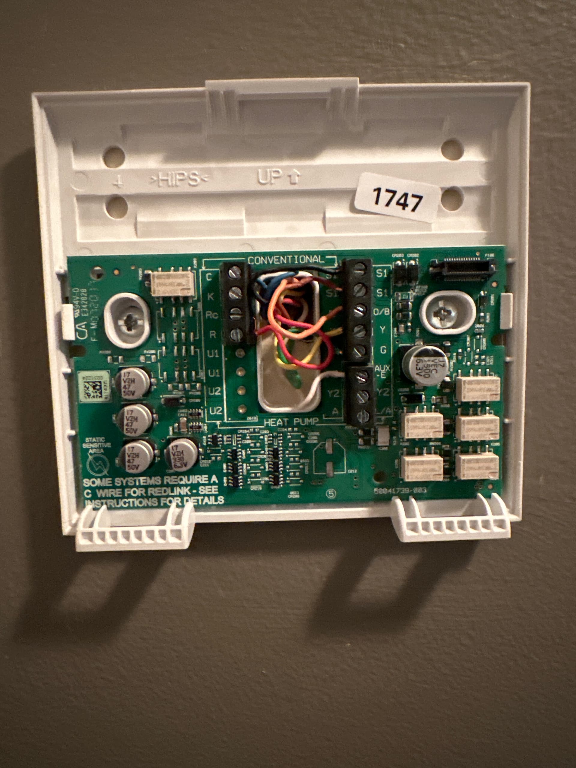

I feel as if I have done something wrong,
System had one jumper between R and RC, Wyze setup said to plug in RC,
System does not appear to have a heat pump and has no OB wire,
Two extra wires were labeled S1 on system.
Can you guys help me?

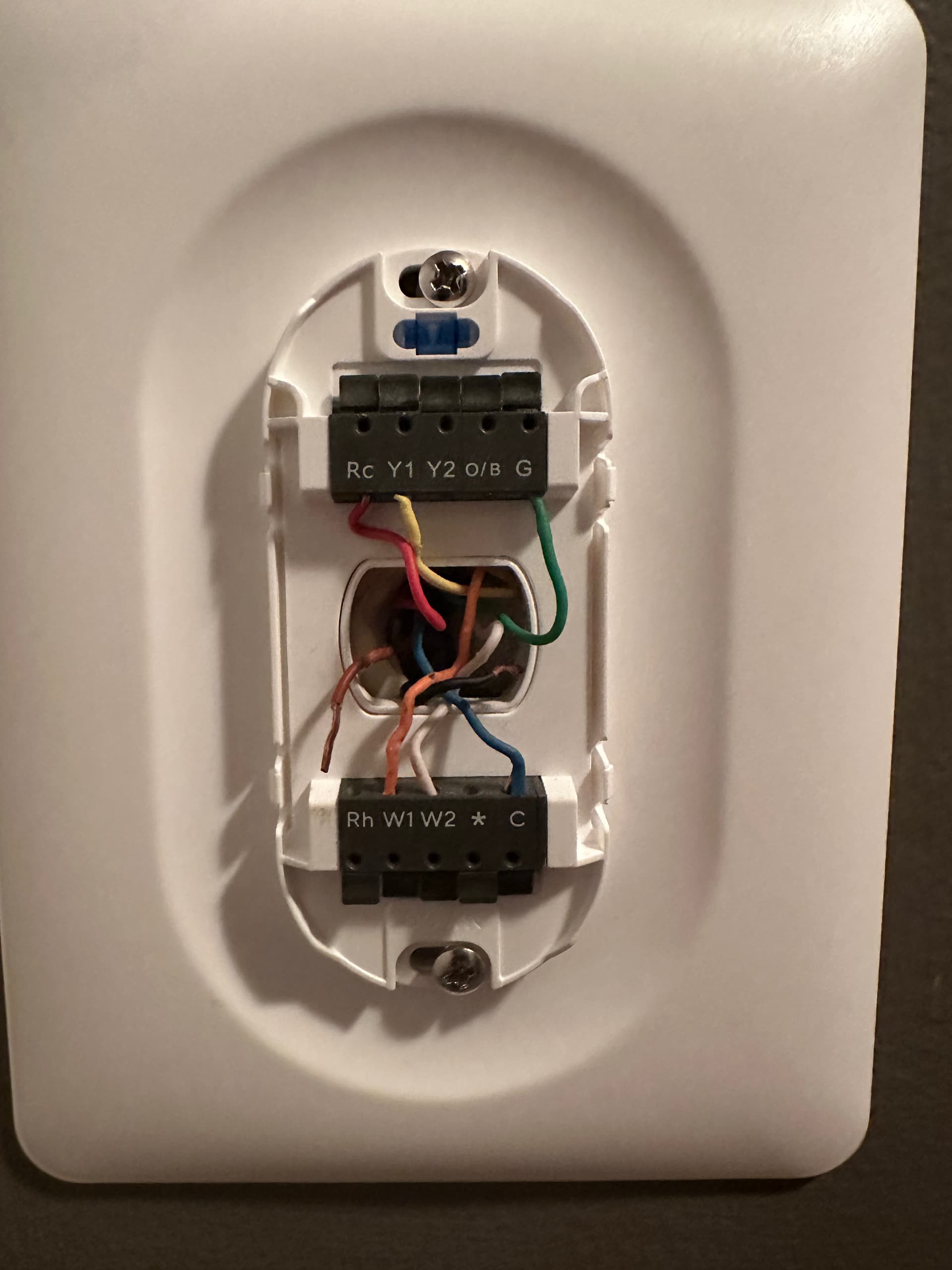

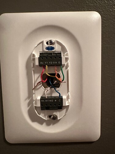

York model fc43b3xn1h, apparently I do have a heat pump, here is my current setup,
Hoping this is correct
This looks right. Make sure to tell wyze that these are your wires during setup. When it asks you what wires your old thermostat has hooked up, that’s how it knows what kind of system you have, and what outputs to use.
