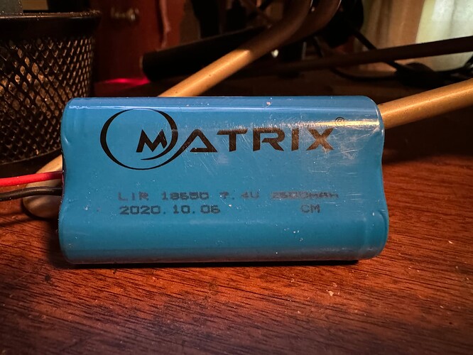

Sorry it took so long to get back. Here is the pic.
I can only upload one pic. The connection has two pins.
That looks like two 18650 cells connected in series to make 7.4 volts. Since ‘broke is broke’, carefully use a knife and cut the wrap lengthwise. I want to see if the charging electronics are on the battery pack or if it is internal. If it is just two 18650 cells connected in series, then buy two 18650 cells and solder them together. I think the rating states it is 2400 mAh so any cells with that rating or higher will be fine. Just watch out for cells that have 9000 mAh because the largest is about 3400 mAh

Here is the pic with the wrap off. Thanks for your help
Ok. Good photo. The electronics are onboard the battery pack. Peel that cellophane insulator off and take another pic.
Would this work?

Just change the electronics? Thanks for all your help!
That one claims to have protection so you could just splice on your old connector. I would double-check. Check polarity also, sometimes the connectors are right but the colors are wrong.
Before doing that I’m interested to know what battery model they used. The applications listed for that Amazon one seem more for lower current uses. Well, the current use wouldn’t be that bad otherwise you’d have hardly any runtime. So the Amazon one is probably okay as long as it’s not worse than the lowest rated ones I see on 18650batterystore.
