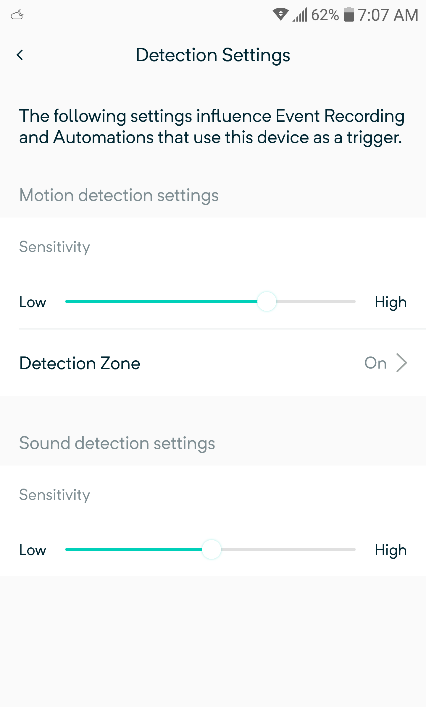

can we see screen shots of your settings. it’s not to spite your knowledge or ability but as a double check there might be something small that is being overlooked. it happens infrequently but it’s worth a shot.
What’s your detection zone look like? I see you turned it on but what area are you defining and is motion happening in the defined zone?
A good troubleshooting step would be to turn the detection zone off, that tells the camera that it’s entire field of view should be considered. Detection zones are usually used to restrict the area considered.
The area i defined is the area someone would be walking in.
turning it off also doesnt fix the problem

I agree with @rbruceporter. the first and only thing I saw was the detection zone but your clarification on that removed that possibility. I also think you should start a support ticket. I’ve got nothing. you seem to have all the bases covered.
and thank you for posting the pictures. as silly as it seems its just one of those things that has helped us diagnose in the past. thank you and best of luck. knowing Wyze they should get this resolved in any number of ways.
