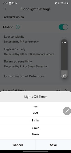

I also have the FLv2 and an automation to turn on for x-time range. I have a detection zone and CPU set for Person and Pet. My FLv2 triggers with the detections and turn off automatically after what appears to be a 20 - 30 second time lapse. Do you have the Motion toggle on or did you leave it off? It should be on. I would like a setting selection that leaves the lights on for a minute before turning off but what I have now works ok for me.

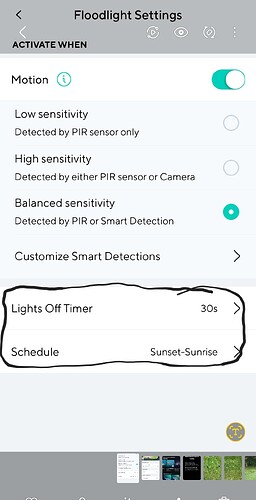

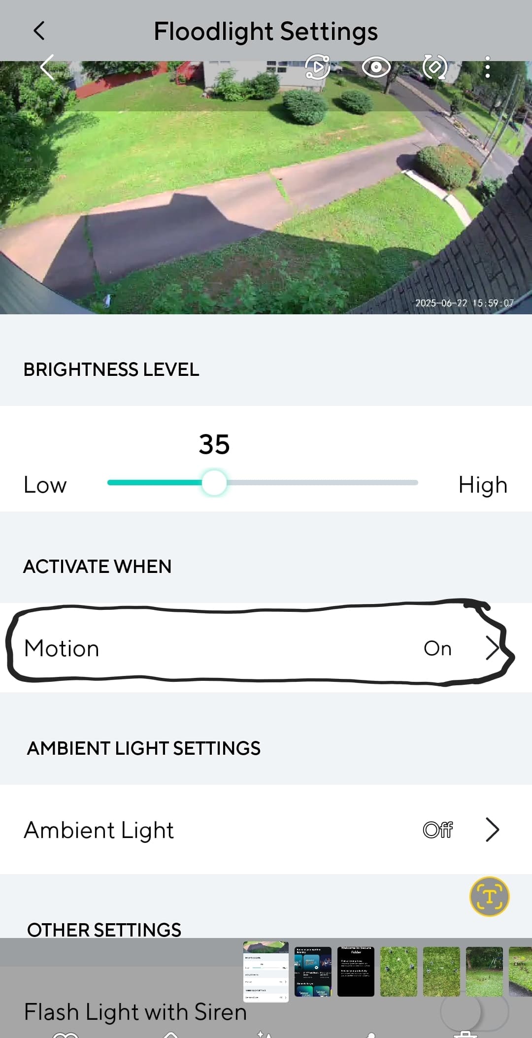

@Blahbleorg - I need to correct my previous post, follow the screenshots included.
This should resolve your issue and mine mistakenly. I had forgotten how to access this feature.
I use that floodlight setting to set the time the floodlight stays on whenever there’s motion: not necessarily when it detects a person, as the OP wants. Did I misread the OP?
No, you did not. He needs to check person detection under smart detections activation, assuming he has CP+ or CPU. If not, he won’t be successful since either is needed for the person detection. An automation or Alexa routine will not help without a subscription. Otherwise he is limited to generic all-inclusive motion.
Thanks y’all. The suggestion was correct to use the device settings > Floodlight Settings > Motion and customize smart detection to enable the floodlights for people. My mistake was trying to set it up as an automation, which turned the lights on, but there wasn’t a way to use an automation to turn the lights off later.
