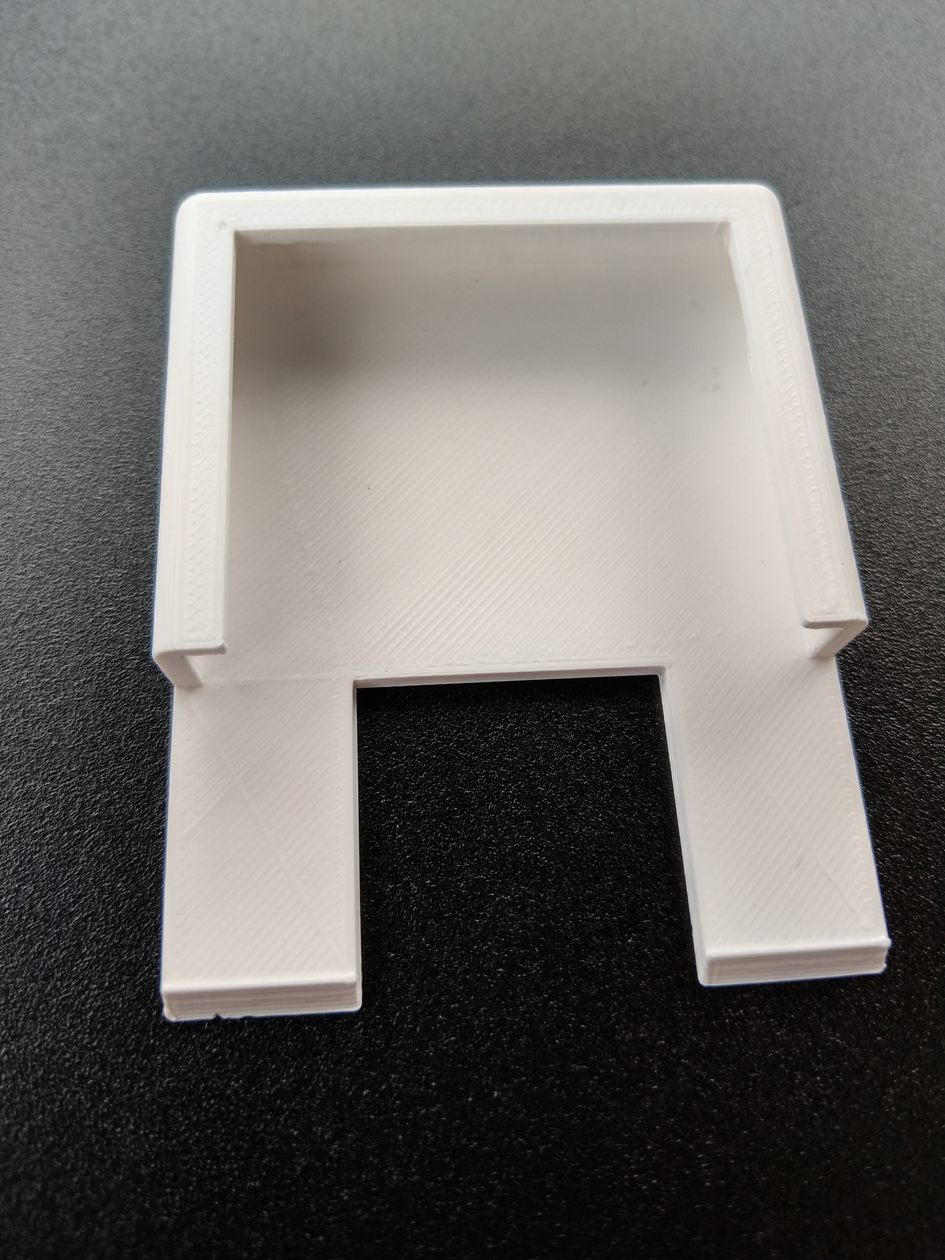

To mount on vinyl siding, I’ve used this mount, works great. Here the files to 3d print: WyzeCam Vinyl Siding Mount by BrandonThompson - Thingiverse
If you can’t 3-D print you can buy those on Amazon also just FYI
They also have these which are more similar to the 3-D printed version and I actually like these better but if you could get those 3-D printed versions from him and go that way
