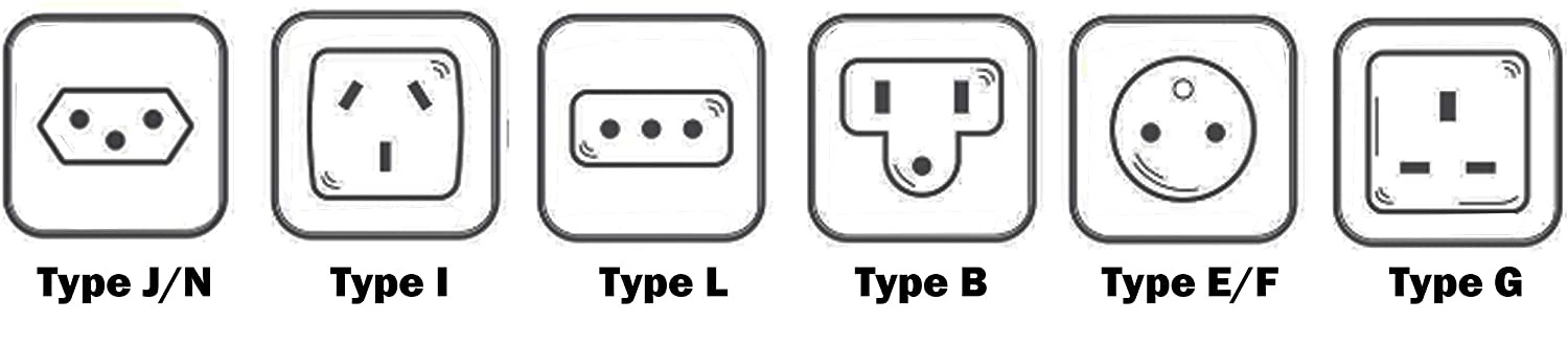

A regular USB power supply with 5 volt D.C. output will work as long as it supplies 1000 ma (1Amp) per camera or the supply that comes with the V3 will work too with outlet adapter.
You will just need to get an adapter to match your outlet.
The Wyze USB power supply can handle an input from 100-240 V.A.C. 50-60 Hz - the adapter may cost close to the same as an USB adapter with correct plug though :thinking:
Euro to US plug Adapters search on Amazon
