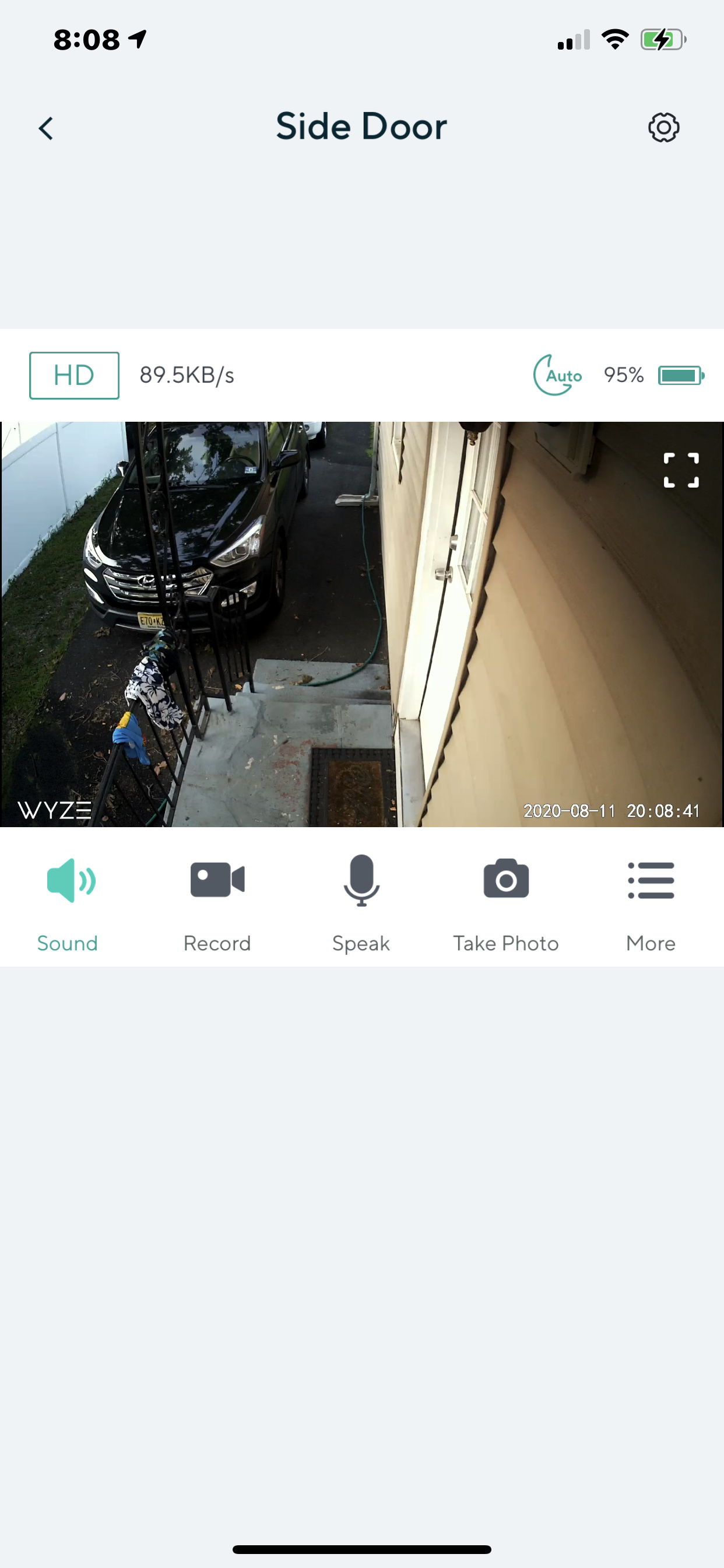

Have 32 gig micro sdcard in Base Unit and 32 gig mico sdcard in Outdoor Cam. Battery was fully charged and shows 97% as of today. When looking at live video can see motion tagging going on in the detection zone but nothing gets recorded. Have messed around with distance and sensitivity but nothing seems to help. Cool down is set at 1 Minute.
BTY, tried a 64 gig micro sdcard in Base Unit and it refused to recognize it. Same card is good in windows 10.
Also, when I am in Live View mode and then look at Album and then return to Live View all I see is a black screen where the video should be. I have to back out of the Outdoor Cam and then select it again to get video again.
If I select ’ Record ’ I can see that in Album as a video and if I select ’ Take Photo ’ I can see that in Album as a photo so the camera is manually recording to the micro sdcard but records nothing during motion.
