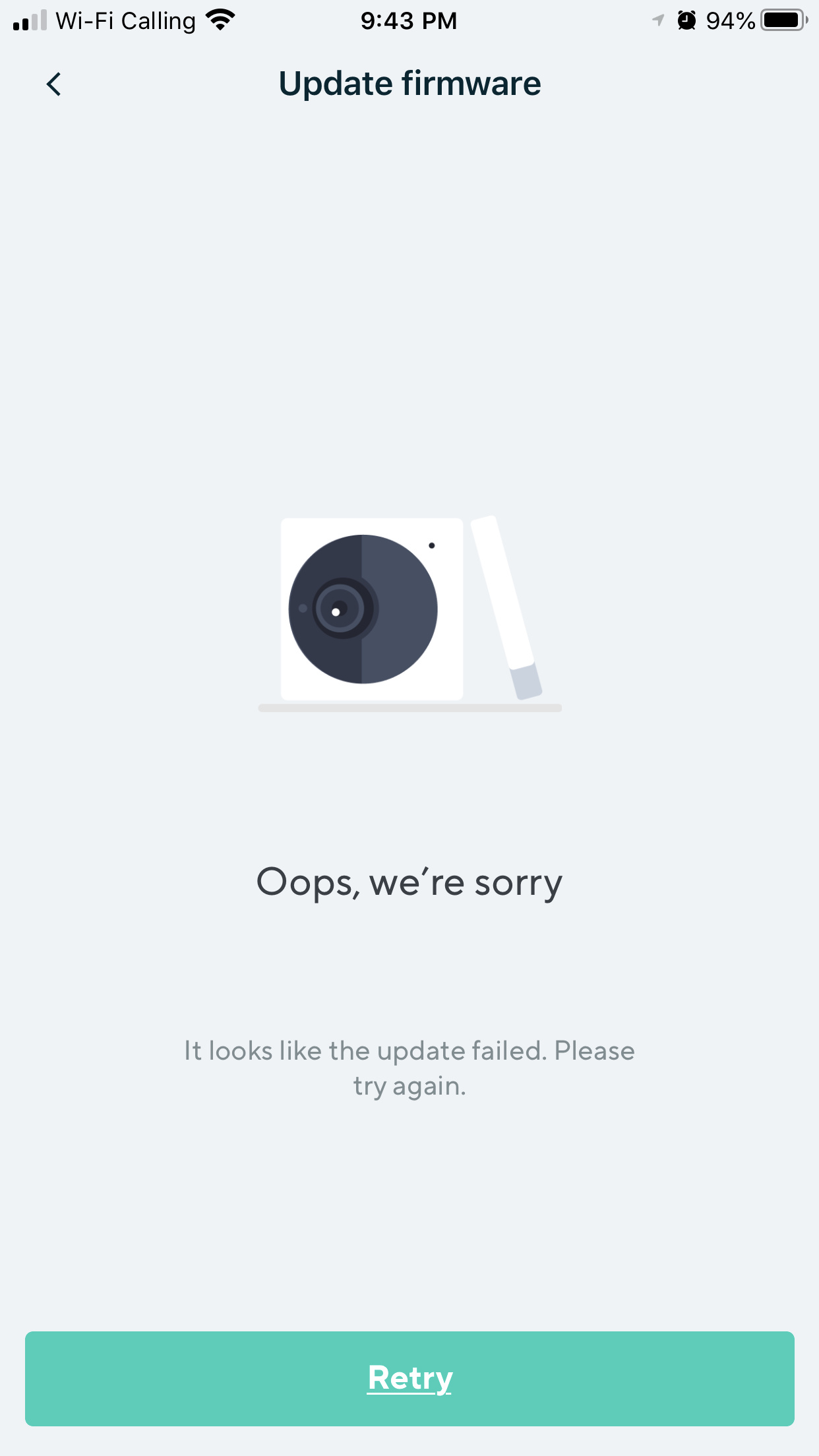

There was a firmware update released 9/9 for the outdoor cam. Has anyone successfully updated it?I keep getting this error a few minutes after starting the update. Now I can’t turn my cam off unless I flip the switch.
