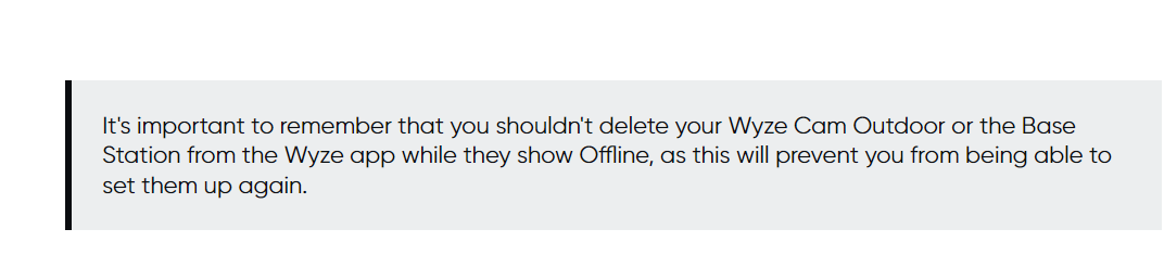

In the fine print that nobody ever reads including me there is a short line that states do not delete the camera when off line or you will not be able to set it up again. I’ve never done it but others have and didn’t get their cams to work again. Take it out of the box and try it out someday, you might get lucky.
I am pretty sure I turned the camera foo before deleting it. Thank you for pointing that out. I too had not read that or if I did I had forgotten it. I have so few problems with any of my wye products
