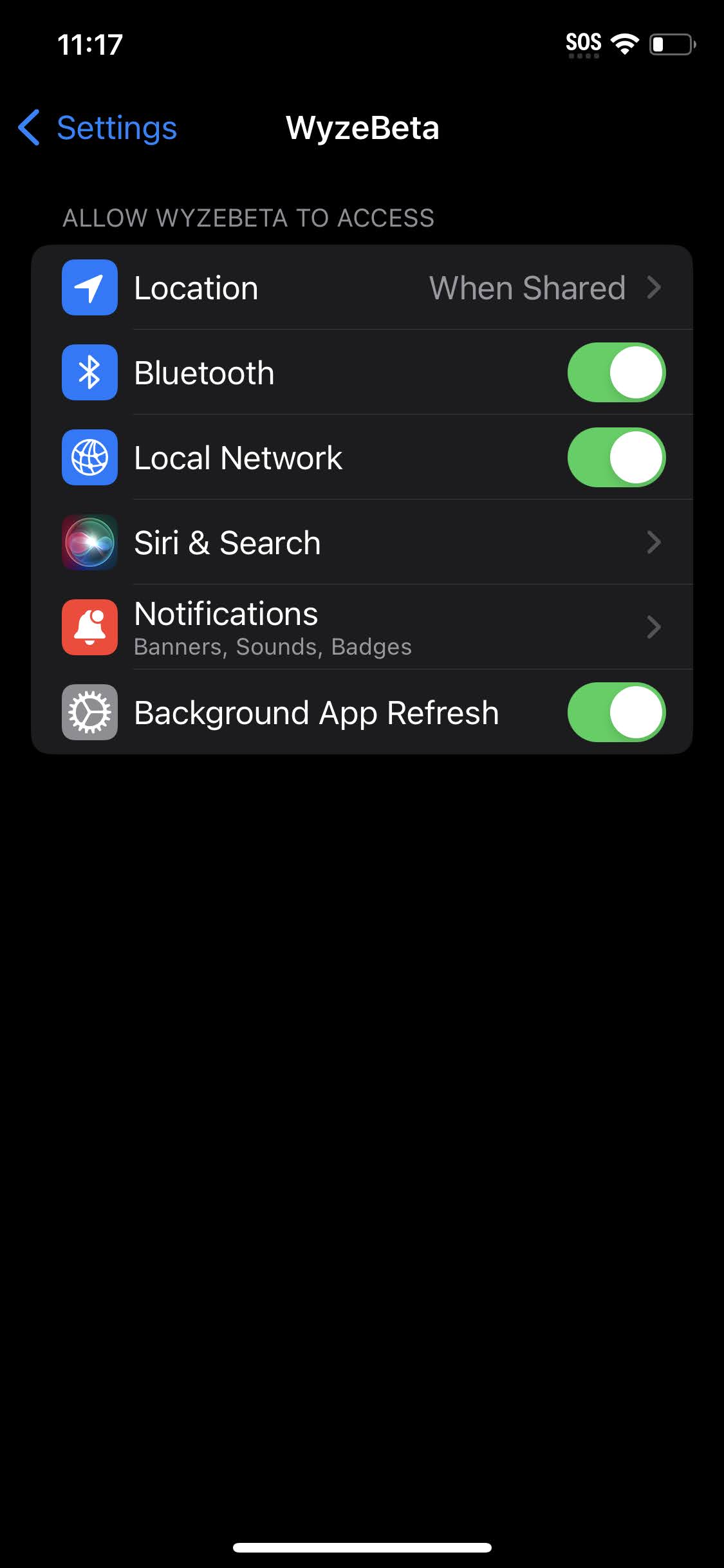

Check the App settings to make sure it allows Bluetooth. Here are my iOS Settings for the Wyze App:
I am currently testing the beta app which is why mine says WyzeBeta

i double checked my Wyze app settings and i have bluetooth allowed
