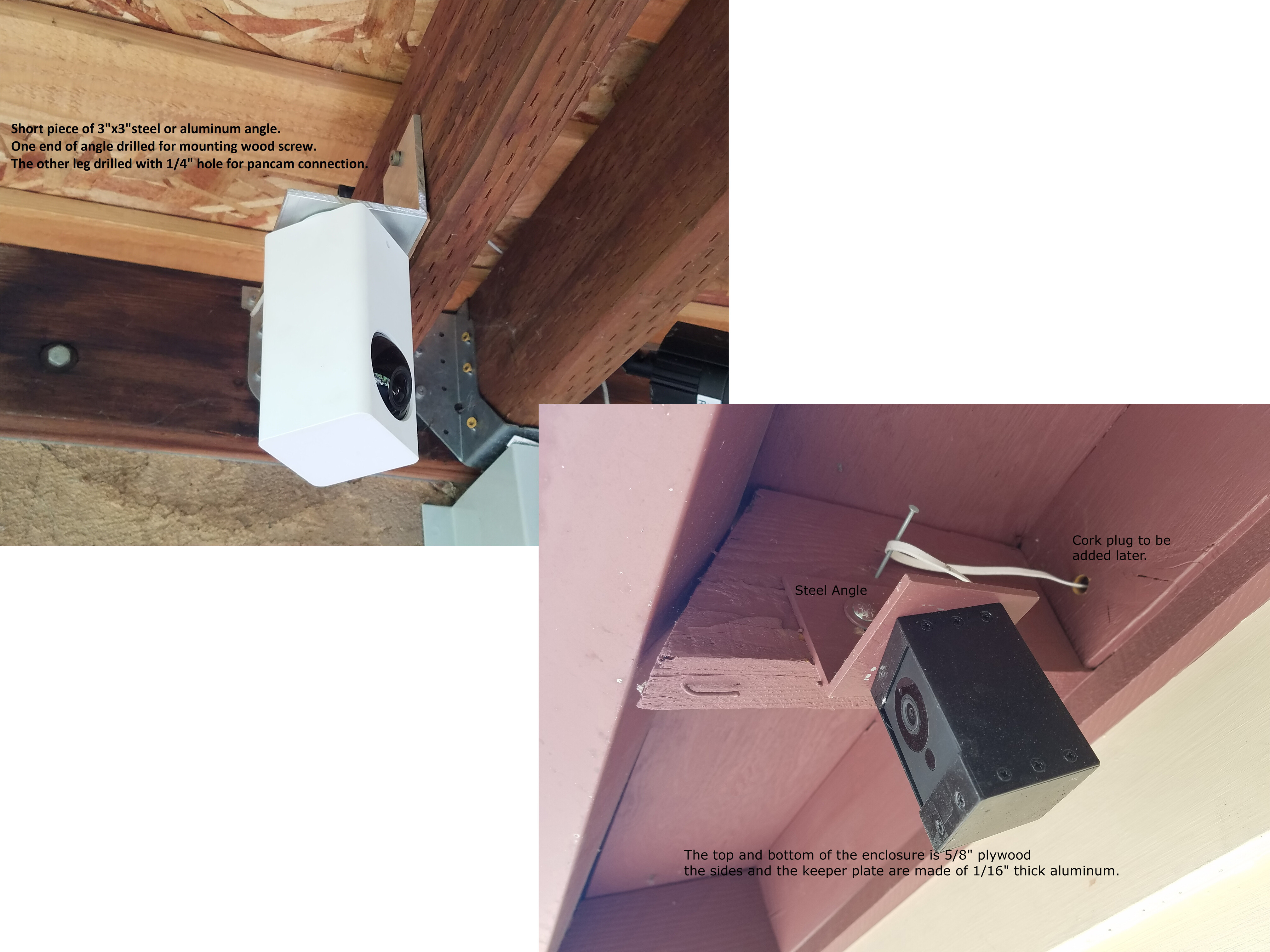

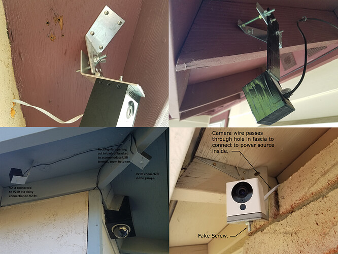

Below are some pictures of camera mounts. All of the pictured mounts are homemade (except one)
All of the pictures of homemade mounts are for V2 cameras but will accommodate the V3’s.
Also, there are many kinds of printed and manufactured mounts available through links provided in various posts. Most of these are for V2’s but V3 versions will be available soon if not already.

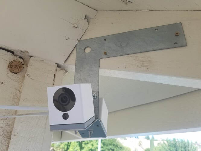

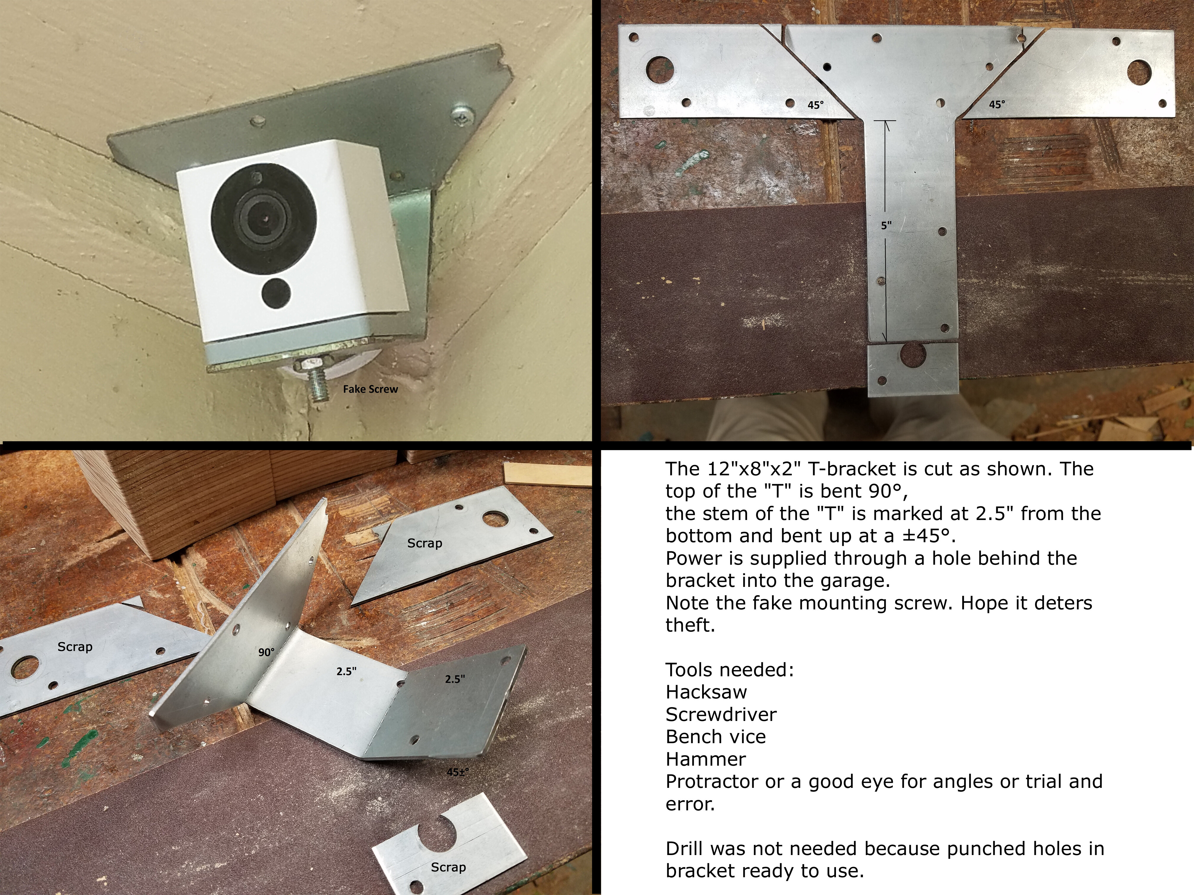

T 1-3 Bracket Corner Mount ed

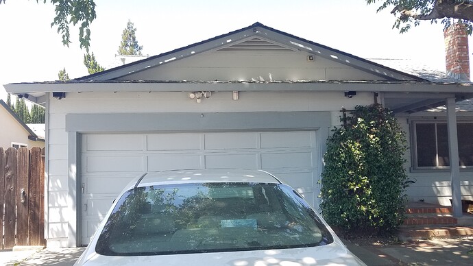

I would think a lot of people know about 180° invert options in the cameras. I certainly do as in the pictures of post #2 there are two inverted cameras. He is a picture that includes an inverted camera:
I’m not sure what you mean by “awkwardly made mounts to solve a software button”. Every mount shown can accommodate and inverted camera. Some of the mounts would need some adjustment of their attachments to the structure.

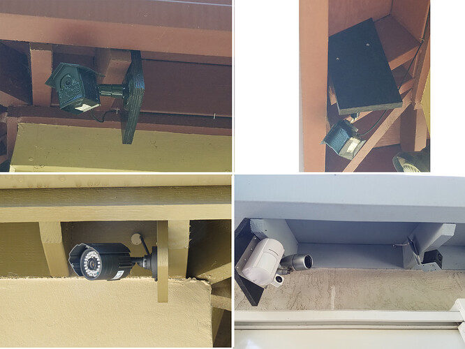

The first two cameras pictured in post #2 are articulated mounts that can aim the cameras with simple adjustments. The very first camera mount shown, Is not pretty and has a cluttered appearance, and it was tough to make.
The second camera pictured only requires a strap hinge, a piece of two-inch steel banding, and a long enough bolt with some nuts. A close-up view shows how simple it is.
The remaining single-camera mounts only require one piece of metal in the form of an L-bracket or a T-bracket, and when cut and bent make a simple support that is hardly visible from a distance. These mounts are very resistant to loss of aim by bumping. In the following picture how many V2’s are there?
There are six V2’s.
I have found for my situation that fixed-aim cameras are all that I need. Some of my old analog cctv cameras use swivel-ball aim adjustment, and can lose their aim when bumped by dusting or animals. My SWAAN analog cameras use an articulated knee joint with a radial splined grip. Very resistant to bumps. The mounts I made are very resistant to bumping-but can be re-aimed if needed.

The power for some of my exterior-mounted V2’s come through holes in the exterior walls of my garage. The holes are only 9/16" in diameter big enough to pass the mico USB terminal end through. The hole is then plugged with a cork painted to match the wall’s color. The cork is also notched to accommodate the power cord. Inside of the garage, the power-adaptor end of the camera’s cord was connected to a regular extension cord that was in-tern plugged into a wall outlet. Later the extension cord was replaced with a hard-wired permanent extension of the wall plug. Drilling the hole in the wall is quite easy if the right drill bits are used. In stucco, drill a pilot-hole with a 3/16" diameter drill bit.
Then use a 9/16" diameter spade bit that has a wire pulling hole at the end of it. Drilling in a wood surface only requires the 9/16" spade bit. See previous posts:
Pulling WYZE cam wire through wall easy way
Put a cork in it. Keep it tidy and bug resistant
Below is a picture of an extension cord powered V2 from inside the garage.
