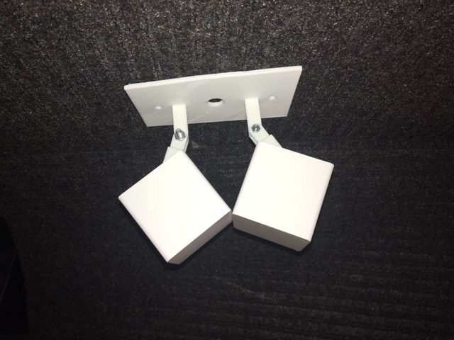

I will work on the wall mount this week, also waiting for my White Filament to arrive. I also want to make a wall plate that hangs from the ceiling, this could then support up to 4 cameras (btw, I realized that I forgot to put a hole in the center of the plate for the power cable, was in too big of a hurry). Hope this helps!!

At least this time I didn’t forget to put the hole in middle of the plate :slight_smile: I plan on mounting this on the ceiling in the hallway so I can see both directions. I wondering if I could fit 3 cameras if I slide the 2 at the end all the way over and then put the 3rd in the middle on the opposite side?
Anyway hope you like it…
John
I wanted to see if I could fit 4 cameras on plate by putting them on the corners. I only have 2 cameras right now, I have another 6 arriving on Monday, but this is how it looks with 2. Looks like 4 would fit fine.
