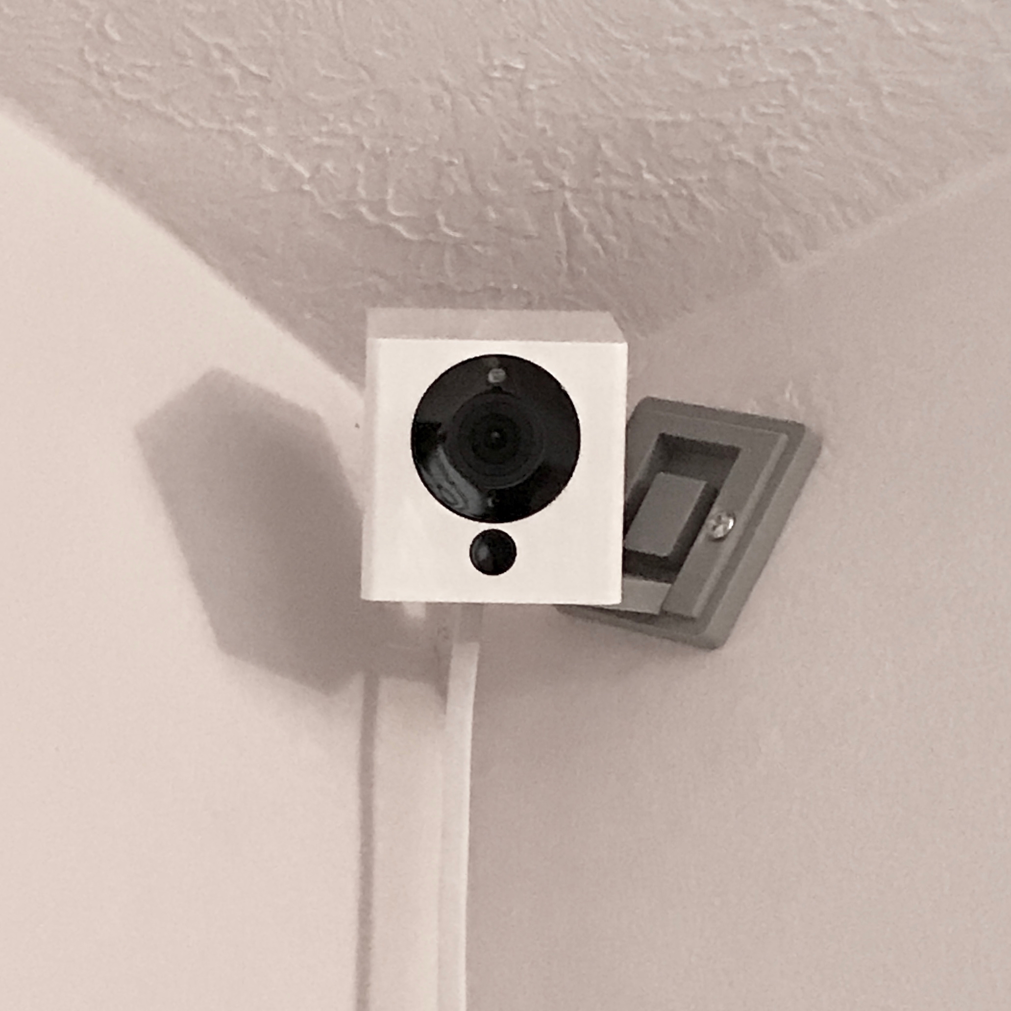

The magnetic mount is great for temporary locations or surfaces that can’t take a screw. But rather than screw the metal ring to the wall, which still has the problem of the camera positioning being disturbed if you touch it, I have drilled a couple small holes in the sides of the gray foot. With these holes I can use a small wall anchor or two for a very secure immovable mount that will be easy to patch if removed. In the photo below, I used only one of the holes and a small drywall anchor and the camera is rock solid.
