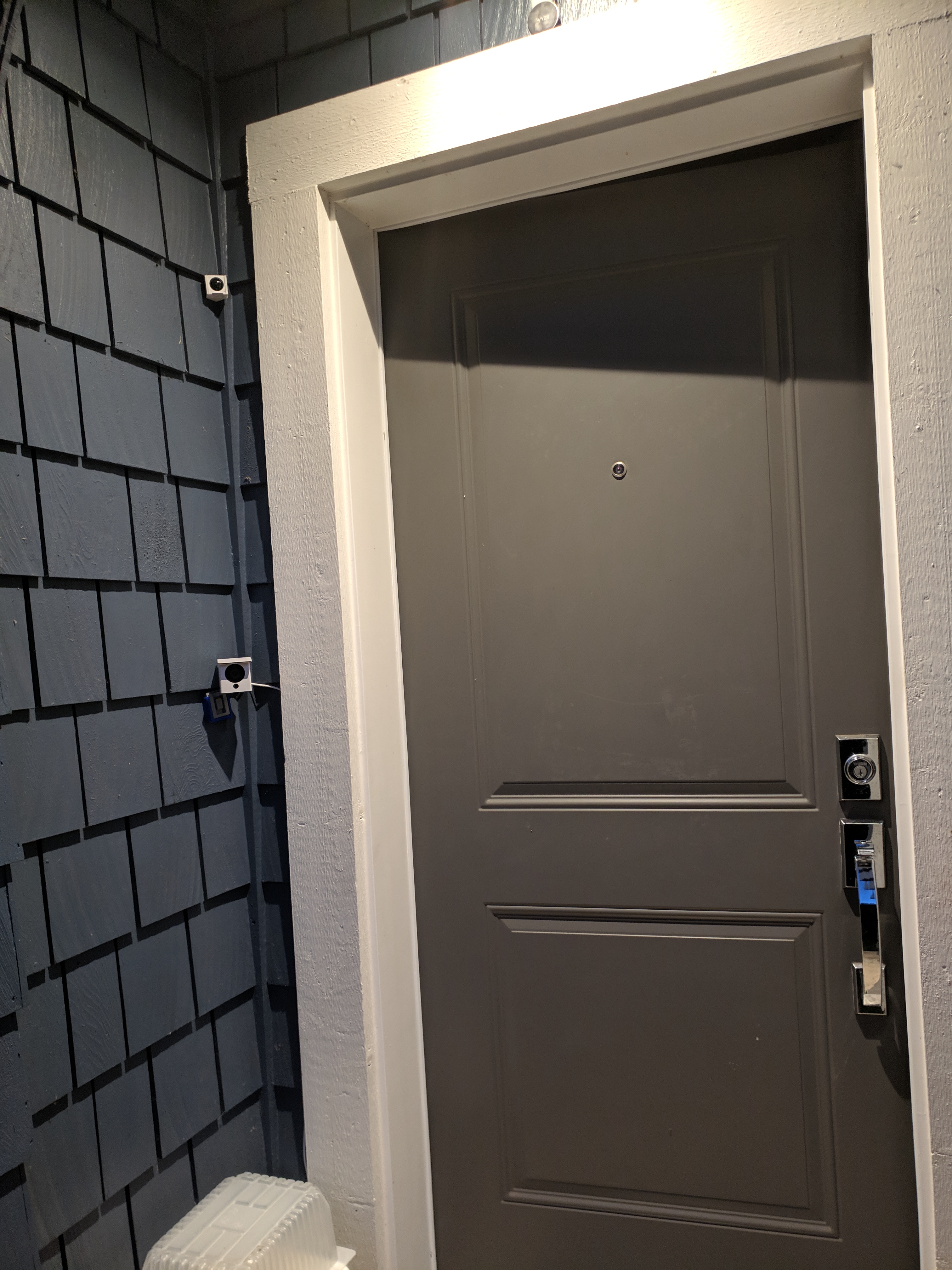

If you add a PIR sensor to cover the same area as each camera (which is what I do) the notification pops up in a few seconds. I frequently have to wait for the video to load and refresh before I can view it.

Excellent tip! Did not even think about that since I don’t have any Wyze sensors set up…yet… :slightly_smiling_face:
You should really give it a try assuming sense is stable for you. I have detection turned off for my camera and only use the motion sensor to trigger cloud events. For just today I have a total of 42 cloud events on my camera and all 42 were triggered by people. Also instead of a 5 min cool down between events the cooldown drops down to around 40 seconds assuming the motion has left the motion sensors field of view.
Before adding the motion sensor I would get at least 40 bug events at night and at least 40 false alerts from shadows/wind during the day. Now it pretty much is always a real heat source moving.
