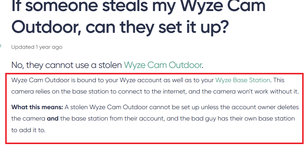

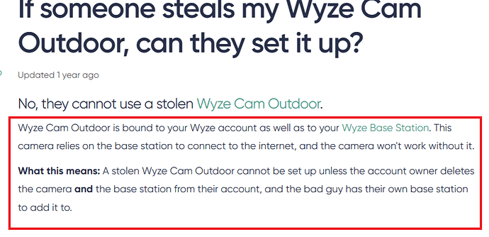

If you did not delete the base and your WCO cameras from the original app/account while they were online connected via wifi take them to E-recycle you will never set them up on a different account.
