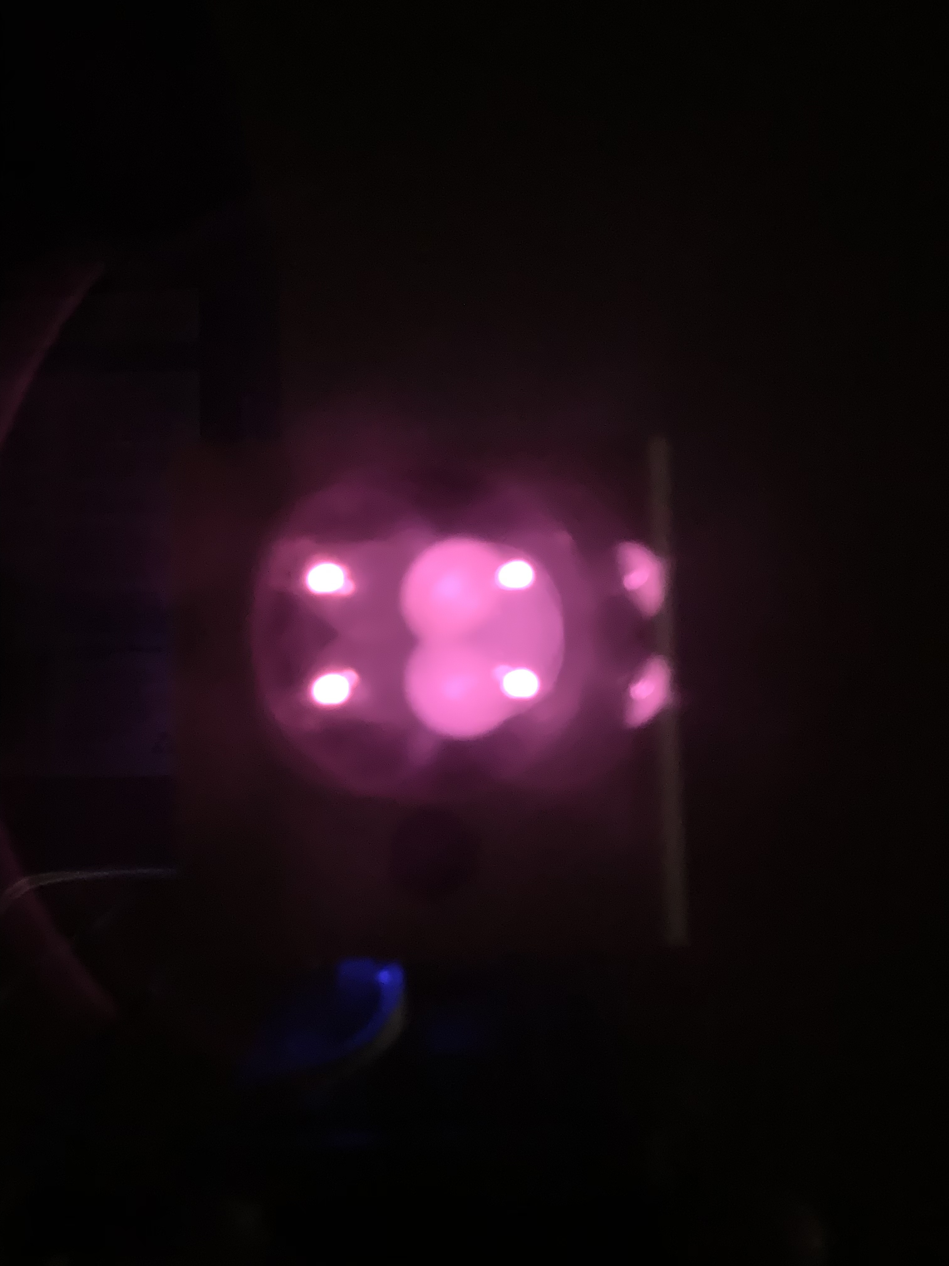

Night vision doesn’t seem to work anymore. IR lights are on and I can see them but image is still pitch dark. What could be the reason? Night vision tried auto and on both. It’s not phone specific as same on both android and iOS.

Hey there Khadanja,
Your Wyze Cam V2 or Pan may be defective. To check if the night vision IR lights are working, please follow this guide.
When night vision is activated, a lens filter is moved so you should hear a click sound.
  1. Place your Wyze Cam V2 or Pan in a dark area.
  2. Connect it to power.
  3. Connect to the Wyze Cam that is giving you issues.
  4. Above the live feed, Cycle the Night Vision settings until you’re at (On) NVOn.png.
  5. Get your phone and open the camera app.
  6. Point your phone’s camera to the Wyze Cam and if you are able to see the IR lights on (make sure you get your camera close), then the night vision IR lights are working.
If you are unable to see the IR lights, your camera may be defective.

So this is what’s happening. I can see the IR lights but no clicking sound when manually activating night mode. Picture goes black n white though during day time but in darkness it’s pitch black even with the IR lights ON.
Hmm sounds strange,
Let’s do some more troubleshooting, now place your camera in a dark cabinet and turn on night vision. Upload what you see here, if you are able to tell what objects are in the cabinet, night vision is on, if you cannot tell and only see dark/black, the IR filter may not be working properly, so you would need to return and replace your device.
