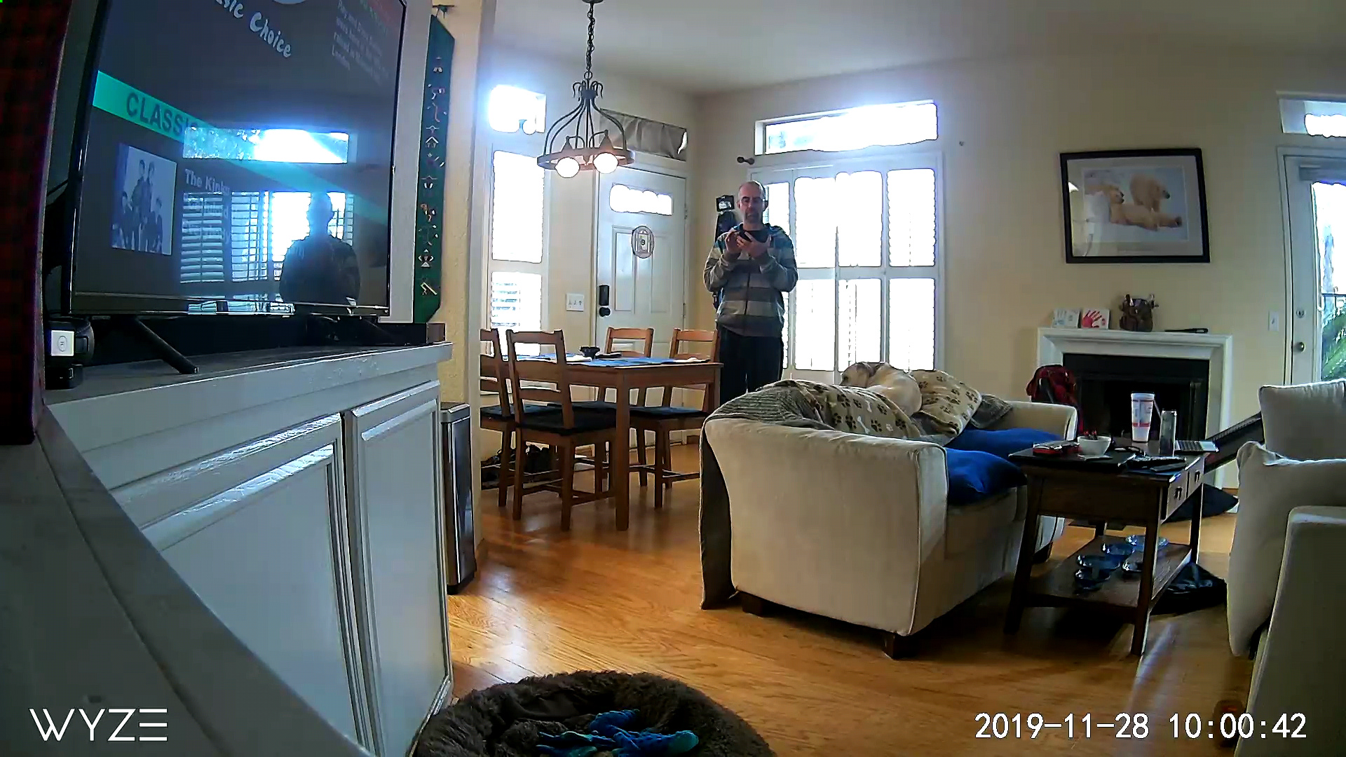

I just bought my first Wyze cams. I got a 2-pack from Amazon. After getting them all set up I’ve found that one camera’s image quality is significantly worse than the other one. Yes, I removed the plastic protective covering from the lenses of both cams. They’re both also set to HD.
I tested them by setting them up in the same location then standing on the other side of the room and testing the live feed and also taking a pic of myself on the other side of the room. With the “good” camera my features are easy to make out. With the bad one, it’s not as clear and pretty fuzzy. If I were to ever have to give videos to the cops, the good cam would probably be good enough to ID the person. The bad cam would be questionable. Is there anything I can do to improve the focus on the one camera? Since I bought them as a 2-pack, I’d hate to return both of them just because one isn’t working well.

Wanna post some example screenshots?
Sure. The one from 9:57 is the blurry one. If you zoom into my face you can see how blurry it is compared to the pic from the other camera. Ok, never mind. The app won’t let me upload or attach the pics to my post. But one camera is more blurry than the other. I’m not opposed to opening it up but wouldnt that void any warranty?

Ah, I see them now. Yeah, the first one definitely seems like it needs a focus adjustment. That isn’t too difficult to do if you take apart the camera, although there’s some glue that keeps the lens in place. If you screw it with enough force the glue comes off easily enough though.
