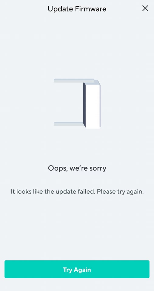

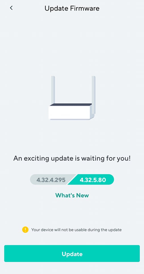

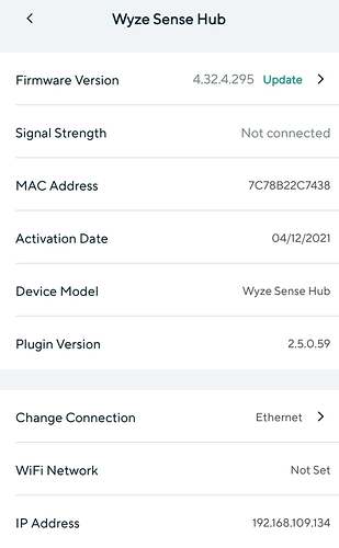

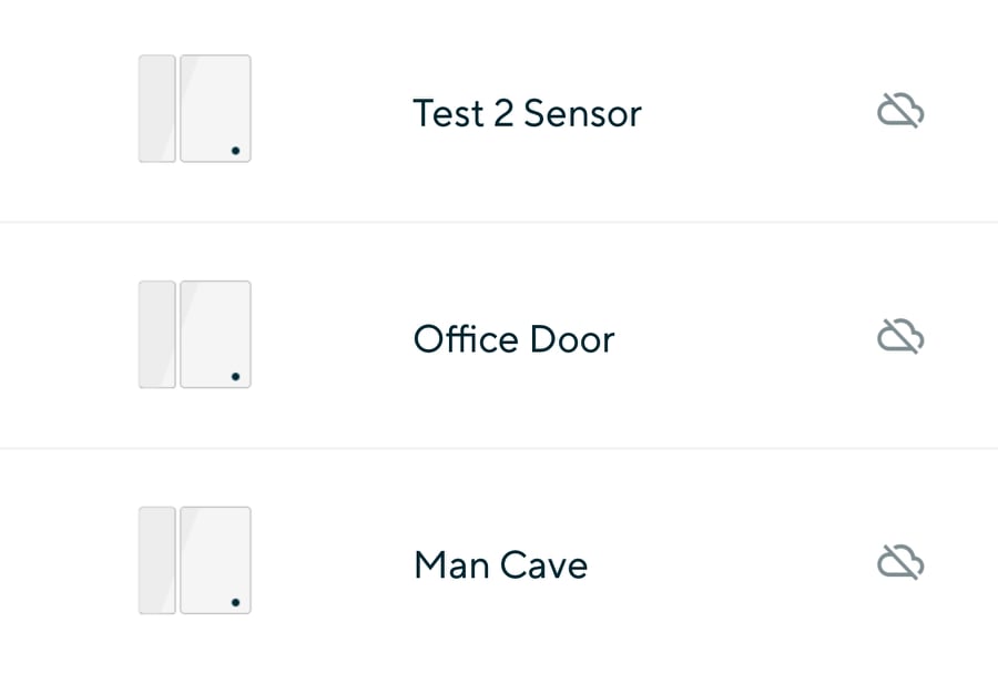

The sensors show offline. I am connected via ethernet and you can see that it has an IP address; however, I did not see it listed on my router (strange). I tried to do an update, but it failed. What is really blowing my mind is the hub is retrieving the video cams that are connected to it. When I did the power cycle with the power disconnected to the hub, I got the “ready to connect” message from the speaker. It should have just connected to the network via the ethernet cable. I am currently readying an old UPS to power the hub when I am able to reconnect, as it is apparent that Wyze did not take power failures into account for their design of this hub. I might add that I was surprised that the ethernet was connecting at only a 10 MB rate; 100 might have seemed a bit more reasonable.

The cameras don’t connect to the hub, they connect directly to your wifi so any hub failure would have no effect on them. The ready to connect message means that for some reason the hub is trying/ready to connect to your Wyze account, not the network. Did you try adding the hub to your account?
That just shows you’ve paid for the service, not that the hub is connected to your account.
How do I show you that?
If you don’t see it on your router, can you ping the IP? If not, it isn’t connecting to the network. You may need to re-do the HMS setup, readding the hub and sensors. You can try to just run the setup of the hub by running the Add Device process and then adding sensors to it to see if that resolves the issue.
I will re-do the HMS setup reluctantly. It baffles me that the sensors show offline, but the information from the sensors shows on the app, although it may be cached information which means I might have low batteries in the sensors and not know it. While this may be a bandaid to get the system up and running again, it is not a real solution. Wyze needs to take power failures into consideration; especially since in is issuing security certificates for our insurance company to get lower rates.
