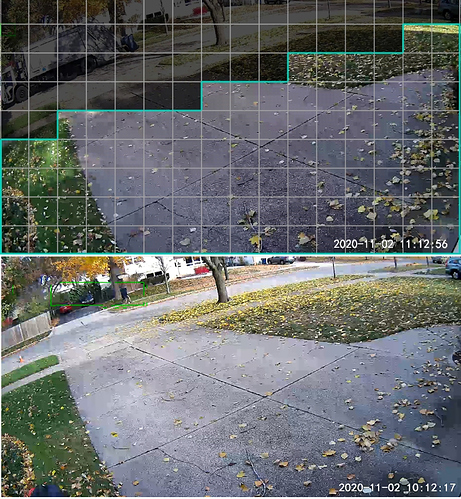

I love being able to set a custom detection zone, but I’m getting notifications and subsequent recordings of events outside the designated zone. It’s like the whole area independent of my settings.
I came on here to post the same thing.
In most of my videos the motion tagging is outside of the set detection zone.
Same here, it’s buggy. Im trying to leave out a small palm tree out of the detection zone and I still get notifications from it. Same thing if I entirely flip the zones.

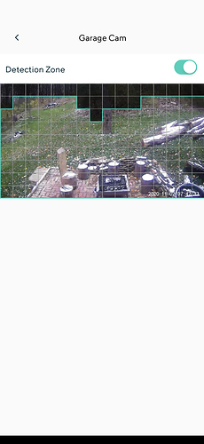

Can someone from Wyze clarify this for certain - which squares are supposed to be excluded? The dark ones or the light ones?
The dark ones make up the exclusion zone… I think :thinking:
I’ve done it both ways and the problems persists
If the dark one’s are the exclusion than it’s not working correctly. And this was a triggered event.
