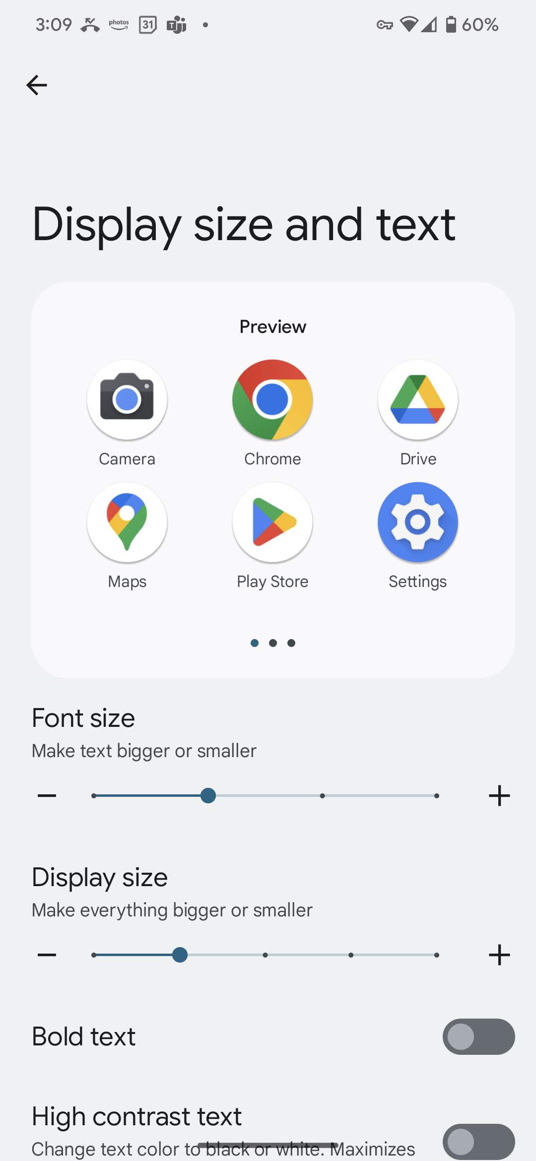

FIXED for me on Pixel 3a XL
Settings > Display > Display Size
Set to “Default” or larger.
I had it on “Small” prior when I had exactly the issue described by @michaelkmcgee
I would like to go back to “Small” display size though.
Changing a global user experience setting on my phone isn’t an acceptable workaround.

Had been dealing with the app doing this for months, just changed around that same setting, Settings > Display > Display Size > Default and and the landscape mode should work again. Sure would be great if Wyze would address this, especially considering its such a basic feature, that clearly helps with accessibility.
Pixel 3 XL | Android 12 | Build: SP1A.210812.016.C1

Confirmed this worked for me, I had the same issue but it fixed when going into Android Settings > Display > Display Size and changing the size from small to default on my Pixel 4a 5G (Android 12). As another note, I also have Arlo cameras and this poses the same issue. It appears it is not just Wyze cameras with this problem.

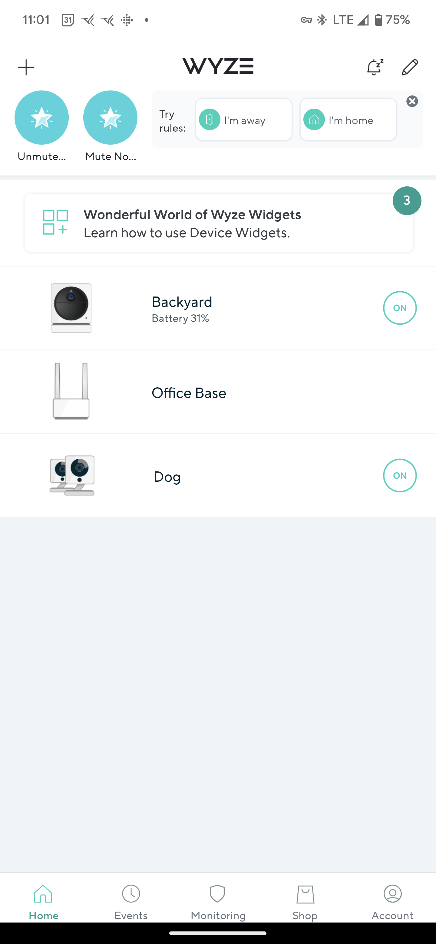

This is the screen I’m referring to.
However, on the 4 video stream screen, if you swipe to go back to the home page of Wyze, it rotates the 4 video stream screen to portrait and then puts it back to landscape but it doesn’t go to the Wyze home page.
i can confirm this aswell, i have a google Pixel 6 Pro. when I got my phone I changed the display size to make things smaller to make more things fit on screen. i just reset it to the factory default and now it works again.
When in landscape viewing multiple streams, I can’t go back to the main window. Swiping left just puts it in portrait mode, rather than the main Wyze app homepage. I have to be very quick and lucky to swipe left and then down because the view changes even though I don’t change the direction of the phone. The phone is still in landscape mode.
Video of what I’m talking about: https://photos.app.goo.gl/rYvkkHNrmC8jJkWn7
My display settings are set the same as the above post.
